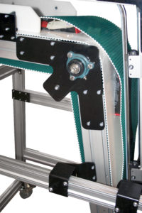

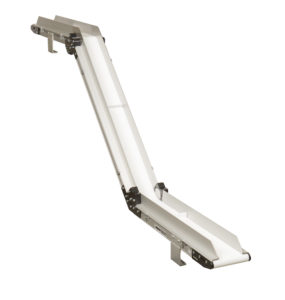

Z-Frame Conveyors
Perhaps the most well known method for elevating product is the Z-Frame conveyor. As implied by its name, Z-Frame conveyors are designed with either one or two pivot points, resembling the angled points in the letter Z, to move product up or down along the conveyor.
Z-Frame conveyors are ideal for navigating obstacles within the product flow of production. Often, the lack of space prohibits conveyors from going around an obstruction. Z-Frame conveyors can be pivoted at steep angles to move product up and over (or conversely down and under) an obstacle. Various types of friction insert chains or belt cleats keep product in place during incline or decline movement.
