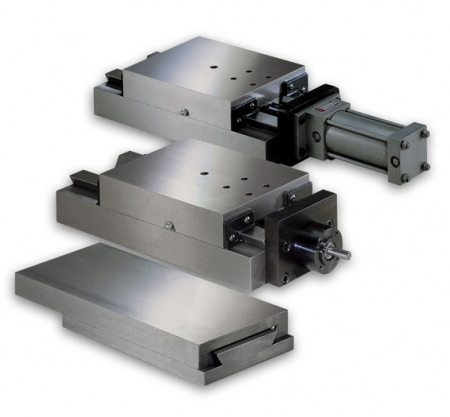

Dovetail slides for simple and cost-effective precision movement
Base width is 1.00 to 36.00 in. and base length is to 200.00 in. long.
Hardened-way slides for ruggedness
Base width is 5.00 to 48.00 in. and base length is to 200.00 in.

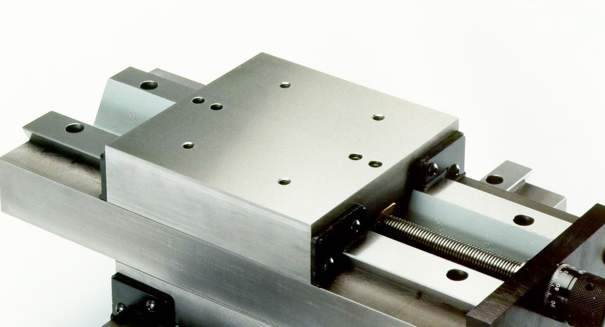

Linear-guide slides in ball or roller style
Base width is 4.00 to 48.00 in. and base length is to 200.00 in.
There are four available drives. Those with ballscrews are ground (with a preloaded nut for a maximum of 0.005 per foot lead error) or rolled (with non-preloaded nut for a maximum of 0.009 per foot lead error).
Other drive options are hydraulic and air-cylinder drives; hand-powered setups with an acme screw; and a rack-and-pinion set.
