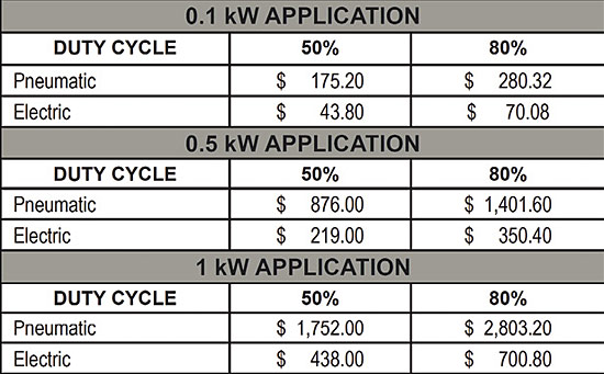

As with any device consuming electric power, the number of times the device works or cycles directly relates to the amount of electricity it uses. Therefore, duty cycle (time working ÷ [time working + time at rest]) dominates electricity-cost calculations for all actuators. Note in this article’s graphs titled, Calculating the power costs of an application, the low efficiency of pneumatic systems make energy costs rise more steeply with duty cycle.
As with most factory-automation equipment, duty cycle is normally high to maximize machine use and plant output. Refer to the table titled, Pneumatic versus electric cost comparison based on duty cycle and kW. It compares duty cycles of 50 and 80% with respect to our pneumatic-application setups. In a 0.1-kW application, annual operating costs for electric actuators are about $130 (at 50% duty) and $210 (at 80% duty) less than what it costs for pneumatic. In a 0.5-kW application, they’re $655 less (at 50% duty) and $1,050 less (at 80% duty).

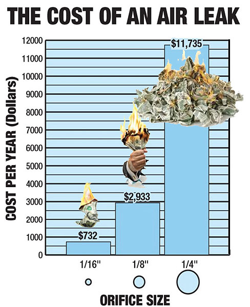

All pneumatic systems or infrastructures leak. Large leaks are easier to detect and correct, but it’s hard to find small ones. In fact, the accumulation of many small unidentified air leaks can significantly increase manufacturing companies’ electric bills.
Refer to the pie chart titled, Air supply for production. This and the chart below it show real-world operational costs. According to the U.S. Department of Energy, about 30% of air supply for production is lost to leaks. Search online for the compressed air systems fact sheet for more specifics. Many estimate that the TCO of an efficient compressor is 76% electricity cost.
Consider the figure titled, The cost of an air leak. One leak from a ¼-in. hole can cost a facility $11,735 per year (at $0.07 kWh) in wasted electricity. Cumulative leaking during peak hours where kWh rates can vary are particularly costly.
