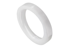

Some linear-motion vendors also sell lubrication units that mount inside the nut. These are usually plastic rings impregnated with oil. Such designs extend the time between maintenance intervals early on, but the plastic rings can eventually run out of lubricant. At that point, the end user must send the screw back to have the manufacturer replace the lubrication unit, or revert to typical lubrication methods. Furthermore, the end user has little say in what type of lubricant gets used and is stuck with whatever the plastic rings carry. Given these caveats, sometimes the features of this setup can’t improve motion designs.

The ball screw’s lubrication reservoir and wiper system must be designed to minimize lubricant loss while providing maximum wear protection. Ideally, the supply of lubricant and ability to seal the nut from fine particles should be combined into a single unit.
This capability is embodied in an innovation called a combination wiper. Combination wipers are plastic wipers with an additional felt wiper inside the ball nut. Felt is an excellent absorber of oil, so it acts as a reservoir. However, it must be protected from water or water based fluids. That is one function of the additional plastic wiper.
Combination wipers increase the nut length slightly, but offer important advantages:
- Superior dual stage sealing
- Reduced maintenance
- Reduced oil consumption (75 to 90%)
- Refillable
- Choice of lubricant
These last two points are especially notable compared to oil-impregnated plastics. With the inclusion of felt, users can easily refill during normal maintenance intervals, while also using the lubricant of their choice.
