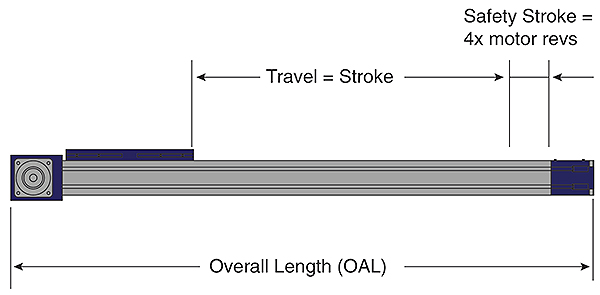

Travel length
The stroke of an actuator, measured in millimeters or inches, is the distance it must move an actuator. However, total movement must include a safety stroke, also known as hard-stop-to-hard-stop distance. Carefully distinguish the difference between stroke and overall length. Tip: During this step, also define the volumetric envelope or total footprint into which the system must fit.

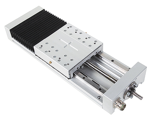

• periodic cleaning or washdown requirements
Keep these factors in mind, and note that demanding or extreme environments may require special seals and bellows to protect the actuator’s moving parts from moisture, dust and other contaminants. Where this is a concern, ask the supplier if these are available.

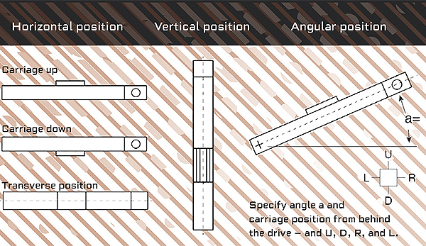

Orientation
Choosing the right actuator also depends on how it will mount in the available geometric space. This determines load and force orientation. Will the carriage be face up or face down in a horizontal orientation? Vertical orientations and slanted placements are also possible depending on the system footprint and application geometry. Each orientation influences the force calculations that ultimately express the actuator’s ability to carry a given load. Note that multi-axis systems need special brackets and cross plates to rigidly connect actuators and reduce misalignment and vibration.

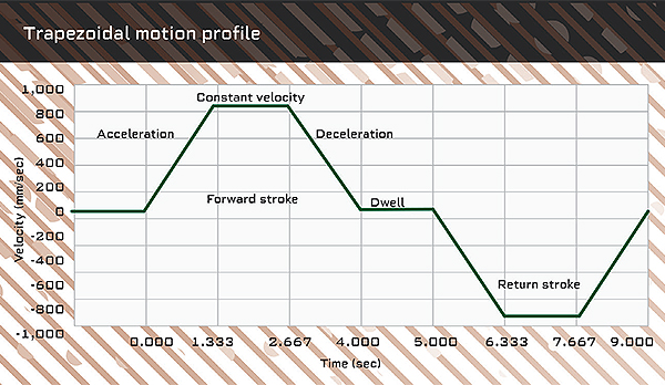

Rates
To choose the best actuator for an application, determine its target motion profile. This includes travel speed as well as required acceleration and deceleration rates. While some industrial duty actuators can support high loads at travel speeds to 5 m/sec, others have limited speed and load capacities. Here, correctly match the actuator to the task at hand.
