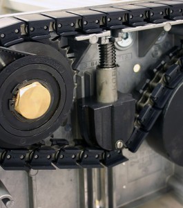

Dinges | Bosch Rexroth: It’s best to think of the conveyor as a complete system, because there are so many elements involved. Yes, it’s important to have energy-efficient motors and drive units, but if the conveyor chain or belt is not properly maintained, you may waste energy through additional friction in the system. Many conveyors use pneumatically-actuated stop gates, positioning units and other product-control accessories, so inefficiency can also occur if the pneumatic system is not properly maintained.

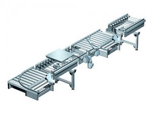

Dinges | Bosch Rexroth: Naturally, if you overload a section of the conveyor, or the system overall, you will waste energy. You’ll also cause additional wear and tear on the moving parts, including the belts or chains, pallet wear strips, as well as the gearbox and drive unit pulleys or sprockets. So overloading a conveyor is never a good idea, even if you don’t care about energy use.
The Rexroth pallet conveyors are designed to accommodate a wide range of loads, up to 300 kg per pallet with the new TS5 platform (including pallet weight and fixturing). Handling heavy loads like this requires a different approach than belts or chains, so the TS5 series is based on a powered-roller concept that controls the pallet momentum much more smoothly. Special curve designs minimize friction, and the low drive force requirements of the “king shaft” concept provide energy-efficient operation.

Dinges | Bosch Rexroth: This is an important point. Proper maintenance is often neglected with conveyor systems because they are simply expected to run and run. As long as everything works smoothly, no one thinks twice about them. But it is possible to keep a conveyor operating like new for years, at optimum efficiency. We recommend an annual or bi-annual tune-up or inspection, as do most conveyor suppliers. A quick, expert review of the system under operating conditions can identify wear parts that need replacing, opportunities for process optimization, and other potential hazards, such as overloading the system.
