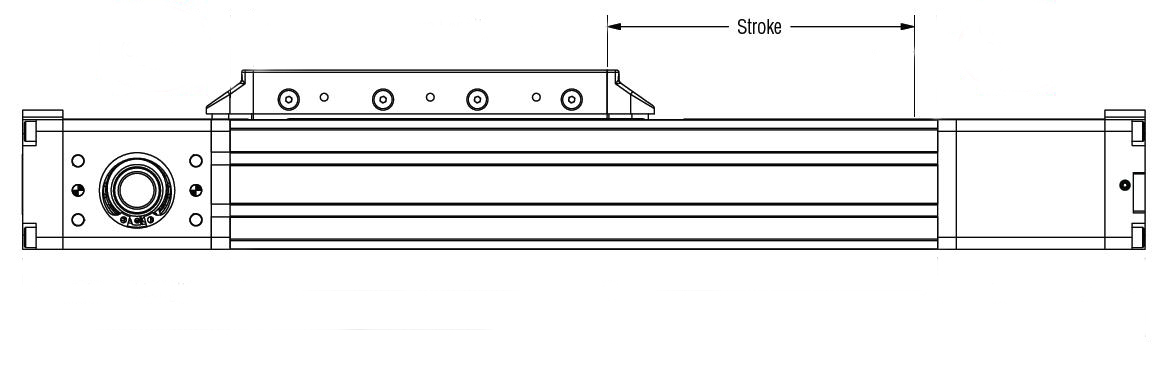

Stroke length
This is the most basic of the length specifications. The stroke length, also referred to as nominal travel or working stroke, conventionally refers to the working travel—that is, the travel needed to carry out the process or application. The stroke length is typically the length between the limit switches.
Rod-type actuators are typically supplied in standard stroke lengths, such as 100, 150, 200 mm. While some linear actuators are also offered in standard stroke lengths, most manufacturers allow the customer to specify their exact stroke length in millimeter increments.
