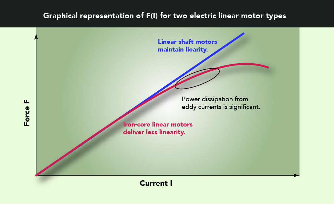

The relationship between current and motor performance lays the foundation for how a motor executes motion commands. If a 20-N force must move to position (X, Y) the controls must know how much current to supply. Ideally the force (F)-current (I) relationship (F (I)) is linear so that a small change in current prompts a similarly small change in force over the entire operation range. But it’s more complicated when the relationship is nonlinear or has a nonlinear regime that takes large changes in current to get smaller changes in force.
Motors with nonlinear regimes necessitate advanced servo loop systems to accommodate changing force outputs for current.

Some motors have a nonlinear F(I) relationships because the changing electromagnetic fields that create and control motor motion induce current flow in magnetically susceptible conductive materials. They are called eddy currents and arise just as current flow in conductors creates magnetic fields. In short, electromagnetic coils in some motor types induce eddy currents in adjacent motor parts. These eddy currents then create an additional magnetic field. Because magnetic fields are a vector quantity, the direction and magnitude of all the interacting fields are important, as they sum up over space … affecting the overall force generated by reducing the field strength between the primary magnetic components.
What’s more, as controls increase current to generate more motor force, eddy currents and their magnetic fields grow. This effect produces a nonlinear F(I) relationship in iron-core-type linear motors. When any large amount of a conductive material moves in relation to magnetic fields, eddy currents result. The presence of necessary heat sinks on ironless linear motors also creates nonlinear affects in F(I) because eddy currents also arise from interactions between the magnetic fields and heat sink. Some design features aim to reduce (but can’t eliminate) eddy currents in these situations.

Linear-shaft motors from some manufacturers have a linear F(I) relationship because the motors don’t have a significant amount of conductive material surrounding or adjacent to the electromagnetic coils. For other motors that have this material, there’s a counteracting magnetic field and power dissipation through resistive heating (I2R). We can see this in a qualitative sense by contemplating equations 1, 3, and 4.
Current and the created magnetic field in the coils is linear (as is the current-force relationship) but the power dissipation of the eddy currents is not. When a design has enough material to interact with the motor’s magnetic field, power dissipation becomes important at higher currents (magnetic field strengths) due to the nonlinear power dissipation relationship. For an electric motor, power into the motor is current time voltage (P=IV) and power dissipated is usually due to the resistive heating loss or I2R. Consider eddy currents: Energy goes to generating current and magnetic fields in the conductive material. This energy isn’t used to generate force between the coils and permanent magnets.
This non-useful power dissipation grows as the square of the magnetic field and has greater negative impact on the production of force at higher currents. This is the origin of the nonlinear relationship seen in iron-core and core-less with heat sinks at higher force outputs. Complicating matters is that there’s an insignificant amount of conductive material surrounding and in the magnetic coils (iron-core motors) or external heat sinks (core-less motors) to keep the motor cool enough to operate.

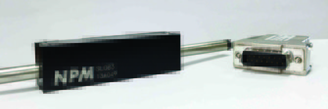

One linear shaft motor avoids this problem. It has a permanent-magnet shaft with a high-intensity magnetic field and a small spatial distribution at each pole. The symmetry of its electromagnetic coils about its shaft (and field properties of the permanent magnets) generate significant force without necessitating an iron core to boost the coil-generated magnetic field. This linear shaft motor’s operating temperature is 135°C without loss of force or motor stiffness due to the motor design. That’s in sharp contrast to core-less motors in which heat can cause separation or movement of the permanent magnets from fixed locations.
