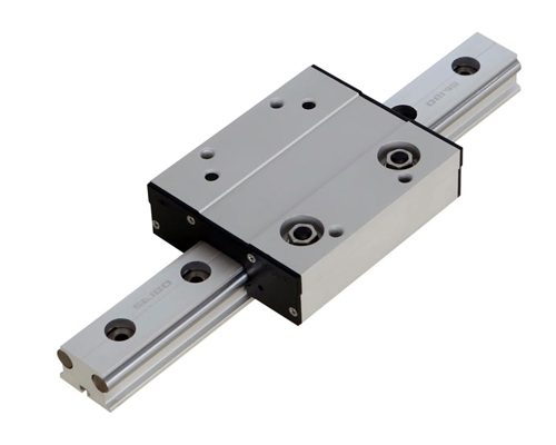

LM76 is the exclusive distributor of SAIBO Linear Motion Systems in the US. SAIBO SB-LGA Roller Block and Rail Systems feature: Low noise, smooth travel, high speed to 10 m/s (120 ft/s), high acceleration to 50 m/s (150 ft/s), low weight, high accuracy, low friction, low cost, and easy installation into new and existing applications. SB-LGA systems are available in three sizes to meet load requirements up to 1200 N. (270 lbs) and lengths to 4000 mm (157 in.)
SAIBO SB-LGA Roller Block and Rail Systems have an adjustable preload system to control the required level of precision needed for most applications. For use in: Robotics, assembly, pick-and-place, sorting, packaging, manufacturing, sampling, laser cutting, wafer handling, and other precision applications. The rail systems are protected from debris, dust, chips, and contaminates by oil filled felt pads held in place by spring loaded plastic end caps. The felt wiper pads also deliver lubrication to the guide and rollers. The wipers are easily relubricated through convenient oil ports in the end caps.
LM76, the exclusive US distributor of SAIBO linear motion components, also manufacturers a broad variety of FDA & USDA compliant bearings and shafting, in inch sizes of .25 inches to 1.5 inches, and a FDA & USDA compliant profile rail and slide system that can easily be integrated into new and existing applications. The bearing options include: Self-lubricating FDA & USDA compliant Teflon® composite bearings in a 304 stainless steel shell, and lower cost bearings with a ceramic coated shell and FDA & USDA compliant liner. Bearings are available in closed and open configurations, and are drop-in replacements for all inch sized linear ball bearings.
