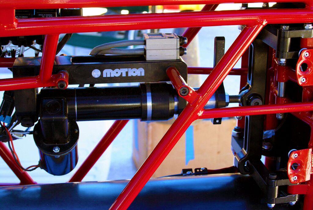

Actuator stabilizes world’s fastest motorcycle
A recent example illustrates how ballscrew-based actuators play a key role in stabilizing the world’s fastest motorcycle called the Top 1 ACK Attack Streamliner. Since it broke the motorcycle land-speed record in 2006, engineer Mike Akatiff and his design team have been working to make the Top 1 ACK Attack Streamliner surpass 400 mph, setting a new motorcycle land-speed record.
Training-wheel-type stabilizers for starts and stops, as well as rear stabilizing flaps for coast-down, are critical safety features. To move these safety components, Akatiff and his team chose Motion Systems’ 1,000-lb-rated Model 85199 actuator. Ballscrew-based actuators have better efficiency than those with acme screws, so they consume less energy to move the same amount of load. This in turn lets engineers use smaller power supplies, which reduce size and weight, critical parameters when attempting to break a land-speed record. Ballscrew-based actuators also have better speed characteristics.
For the motorcycle, engineers modified the 0.979-in.-diameter 85199 to withstand g forces during acceleration and deceleration. So the actuator freewheels at stroke ends to eliminate limit switches and prevention of over-travel at stroke ends. Initiating freewheeling and linear advance stops is a ball cage within the nut ID that hits stop pins at each travel end. Factory-installed top pins mount in the screw thread for the specified stroke, which eliminates the need for limit switches. Screw, nut and ball cage are made of heat-treated alloy steel to resist wear. These mechanical design elements keep the motorcycle rider and others safe.
