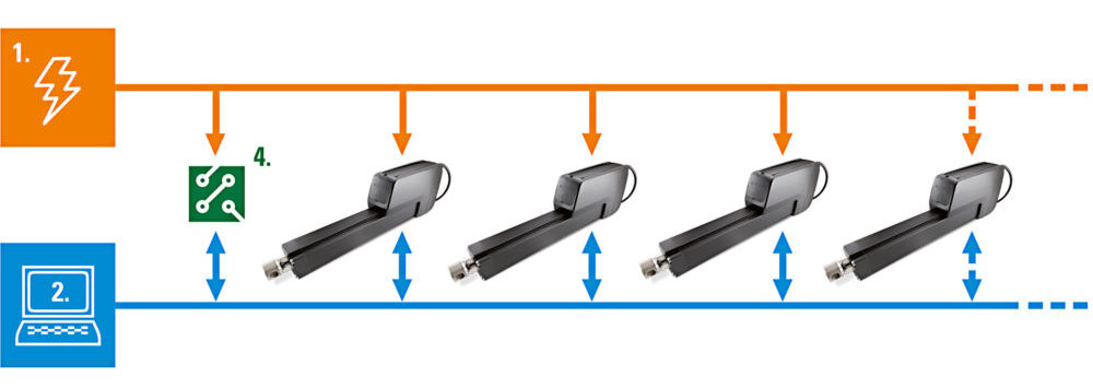

Onboard J1939 compatibility lets linear actuators speak the same language as electronic control units (ECUs) already on such equipment. This in turn enables communication across networks running through a twisted pair of wires. In contrast, traditional electric actuators need stand-alone ECUs.

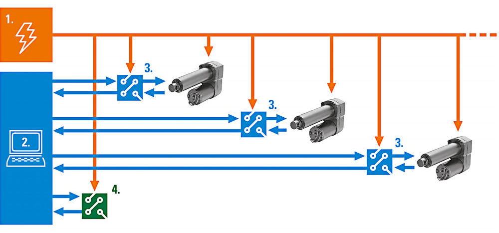

Traditional communication architectures only let actuators connect to ECUs via standalone controls. But smart actuators compatible with the J1939 CAN bus can run in arrays off one main ECU to enable control strategies once too complex for implementation. Such setups also boost flexibility, as a given actuator can work in different applications.
Other benefits of SAE J1939 CAN bus communication compatibility are less wiring and minimized engineering time and cost. Deploying traditional actuators to an ECU took a dedicated communications cable to that ECU, a thick power cable to the equipment battery, and a relay or switch. In contrast, an actuator with onboard compatibility simply connects to the J1939 bus for efficient power-supply connections.
As long as the J1939 CAN bus network stays in use — which is for the foreseeable future — OEMs can incorporate electric actuators into their designs easily and at a fraction of the expense that might have been necessary otherwise. There’s no need for independent controllers, and one actuator model can work in multiple applications.
Another benefit is that J1939 support often lets engineers eliminate a standalone controller. Consider how traditional electric actuators are operated by a stand-alone ECU. A network of actuators with integrated J1939 support only need a single cable run from the controller. Each actuator gets a unique address, listens to every signal from vehicle controls, and responds only to signals designated for its operation. Such smart actuators also feed basic speed and position information (with diagnostics) to the control unit for better automation.
