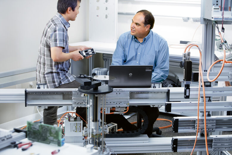

Two engineers having a conversation behind semiconductor automation system equipment from Bosch Rexroth.
Successful and efficient subassembly development should utilize a holistic view of mechanics before proceeding with the electrical and control design. Image courtesy of Bosch Rexroth.

Effective subassembly development should utilize a holistic view of design rather than a serial design. Best practice is to begin by assessing the mechanics before forging ahead with the electrical and control design. Understanding how mechanical elements affect motors and controls will help avoid problems later.

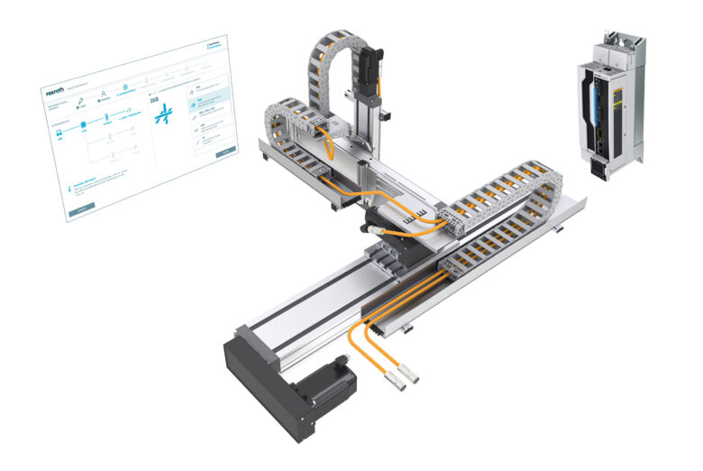

Smart mechatronic handling systems now offer a “plug-and-produce” concept to simplify mechatronics development. Online selection tools let machine builders and system integrators quickly size and select key components — linear systems, drives, motors, cabling, and more — to create a complete handling solution delivered as a single product.
Bosch Rexroth’s Smart MechatroniX handling system uses a “plug-and-produce” concept to simplify mechatronics development. Image courtesy of Bosch Rexroth.
These systems also come with commissioning software for automated drive recognition and utilize drag-and-drop motion sequences pre-configured for various functions, along with digital twin capabilities for programming efficiency.

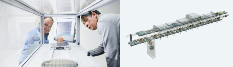

For fab operations with multiple vacuum chambers, linear motor transport tools with an external noncontact motion system provide a new solution for wafer handling. Coils mounted outside the chamber provide drive power for magnetic carriers inside the chamber, offering the precision, feedback, and control of linear motors without having cables pulled into the vacuum chamber. They also allow individual carriers to move independently for specialized processing needs.
Two engineers looking through a wafer transport system (left) and a isometric view of a linear transport system from Bosch Rexroth (right).
Linear motor transport tools like this new Flexible Transport System from Bosch Rexroth feature external noncontact motion and independent movement of multiple carriers for specialized processing needs. Image courtesy of Bosch Rexroth.
