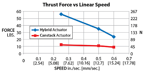

Don’t confuse hybrid stepper motor linear actuators with can stack stepper motor linear actuators. The force vs. speed characteristics, efficiencies, and cost differences between actuators that incorporate hybrid stepper motors and those that use can stack stepper motors can be substantial, although each technology has unique strengths and best-fit applications.

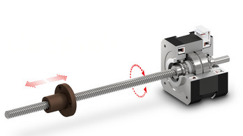

- External: These actuators use a motor with a hollow shaft and integrate one end of the screw directly into the motor, so the nut remains external to the motor. Like a traditional screw-motor setup, the motor’s rotation causes the screw to turn, which advances the nut (and the load) along the length of the screw shaft. In this design, the opposite end of the screw (not attached to the motor) is unsupported, which is acceptable for light loads and short stroke lengths. However, many applications will require support for the free end of the screw, along with a linear guide to support any radial loads.

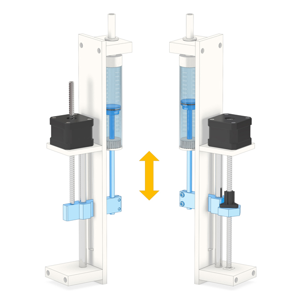

Precision metering and dosing pumps
Whether for the medical, semiconductor, or assembly industries, hybrid stepper actuators are an ideal solution for driving small, precise pumps, thanks to their extremely compact footprint and ability to move at high speeds with high precision.

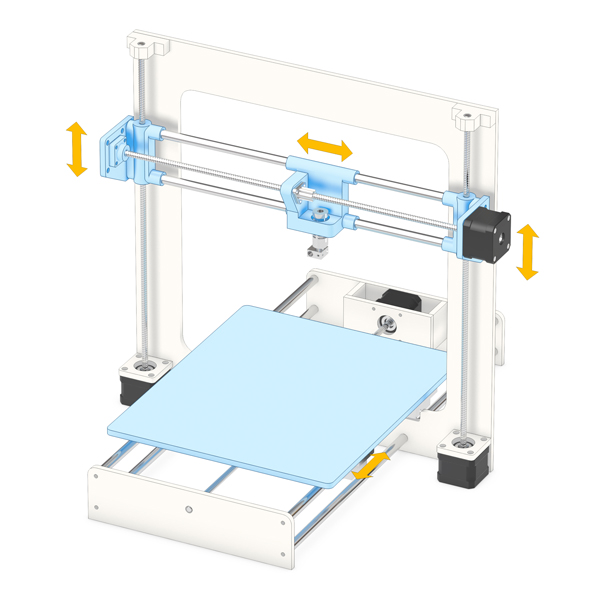

CNC machines and 3D printers
Although one takes material off (CNC machines) and the other adds material (3D printers), both applications require very high positioning accuracy and reliability — two performance areas where hybrid stepper motor actuators excel, especially when used with microstepping control in a closed-loop system.
