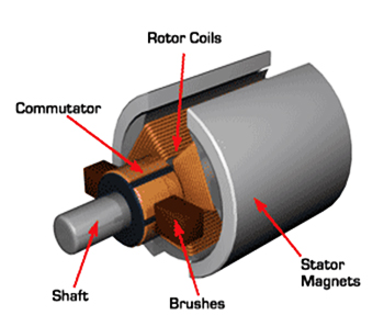

The stator of a brushed DC motor can have either permanent magnets or electromagnetic windings. The more common type for servo applications (and, therefore, for most industrial motion control applications) is the permanent magnet type — typically referred to as a permanent magnet DC (PMDC) motor. The rotor consists of coils wound around a slotted iron core and attached to the commutator. As the rotor turns, brushes make contact with the commutator and deliver current to the windings.
brushed motors
A traditional brushed motor with a permanent magnet stator.

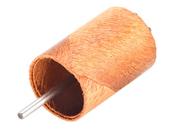

Alternatively, the motor can be a coreless type, where instead of an iron core, the rotor is made from windings that form a self-supporting, hollow cylinder, held together with epoxy. The permanent magnets of the stator sit inside the rotor and the stator is fixed to the motor housing (completing the electrical circuit). The rotor is supported by bearings and rotates around the stator.

A coreless motor has a hollow, self-supporting rotor.
Image credit: Portescap
With no iron in the rotor, coreless versions (also referred to as “ironless,” “slotess,” or “air core”) offer the benefit of reduced mass and inertia, which allows higher acceleration and deceleration rates. The absence of iron also means the motor has no iron losses, so they have even higher efficiencies than traditional iron core brushed motors. And when the motor contains iron laminations, magnetic interaction between the permanent magnets of the stator and the laminations causes cogging and torque ripple. Since coreless motors have no laminations, cogging and torque ripple are greatly reduced.
