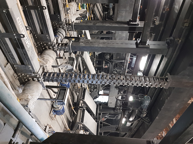

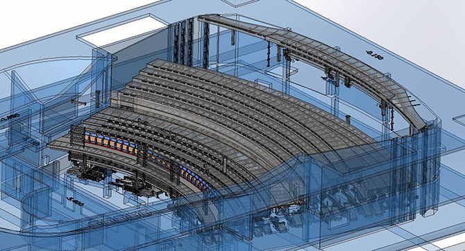

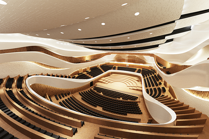

Now a new SERAPID QSX Seating System based on SERAPID rigid-chain actuators and other technologies operates at the Philharmonic Concert Hall at Zaryadye Park in Moscow. The QSX installation is the first to combine raked curved-row seating with a reconfigurable venue system. In fact, the entire hall can transform from a flat floor to raked seating in less than 15 minutes. For the latter, twenty curved rows range from 23 to 30 meters for 677 seats total.
The QSX Seating System is a smooth-operating installation that’s fully automated. It works for straight, curved, or faceted tiers — regardless of rows, seats, or configurations.
Zaryadye Park includes three performance venues, with the concert hall considered its most complex element. The integrator Doka selected SERAPID to deliver the most advanced venue technology available. The concert hall opened in September 2018.
