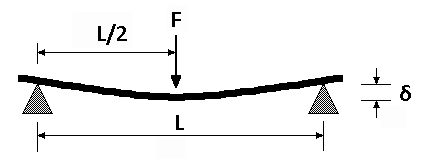

For this reason, round shaft guides are often supported only at the ends, which is referred to as simply supported mounting. But with the full length of the shaft unsupported, the shaft will deflect due to its own weight. And when an external load is added, the load will cause additional deflection as it travels along the shaft, with maximum deflection occurring when the load is located at the center of the shaft’s length.

For a simply supported beam (round shaft guide or a gantry cross axis), the maximum deflection is the sum of deflection due to the beam’s own weight, plus deflection due to the load:
Beam Deflection
E is the modulus of elasticity of the material, also referred to as Young’s modulus. Its units are N/m2 or lbf/in2. Modulus of elasticity is often provided by the manufacturer.
I is the planar moment of inertia (also referred to as “second moment of area”) of the guide or actuator. Its units are m4 or in4. Planar moment of inertia formulas for common shapes can be found here.

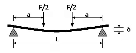

The most basic mounting and loading arrangement is simply supported with a single point load. But linear guides and systems typically use two bearings per guide in order to improve moment loading capability and overall load capacity.
In this arrangement, the load is split between the two bearings, and maximum deflection occurs in two places: at the location of each bearing when the center of the load is located at the middle of the system’s length.
beam deflection equationsWhen two bearings are used on a single guide, deflection due to the weight of the beam (guide or axis) plus deflection due to the applied load is calculated as:
Beam Deflection
