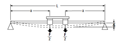

Deflection of shafts with two bearings
When two bearings are used on a simply supported beam, as is typically the case with round shaft guides, the applied load is split between the two bearings, and maximum deflection occurs in two places: at the location of each bearing when the bearing assembly (sometimes referred to as a carriage or table) is at the middle of the shaft.
The beam deflection calculation for this condition is:
Again, we must add the deflection due to the beam’s own weight, plus the deflection due to the applied load, to get a total deflection of:
