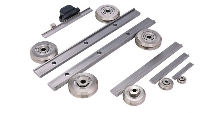

Material selection for linear guide wheels and tracks
Linear guide wheels: Wheels are available in a variety of materials to suit a wide range of applications. The most commonly used materials are AISI 440C stainless steel, 52100 carbon steel, and polymer.
Stainless steel materials should be used in humid, liquid and corrosive environments. Although highly corrosion resistant, some corrosion can occur with stainless steel depending on the severity of the environment. 440C stainless wheels are hardened to reduce abrasion and extend their lifespan.
Carbon steel materials are intended for general purpose use and are also hardened to reduce abrasion and extend their lifespan. They are suitable for most applications and are an economical solution.
Polymer wheels offer certain benefits including chemical resistance, low friction, and low noise. Polymer wheels have reduced load performance versus steel wheels, but polymer wheels provide an economical choice for light load applications and harsh chemical environments.
Linear guide tracks: Standard track materials include AISI 1045 carbon steel and AISI 420 stainless steel. Other track materials include aluminum, which can be used with polymer guide wheels. The 1045 is a medium carbon steel with good strength and hardness properties of 53 HRC (22-25 HRC unhardened), which minimizes wear. The 420 stainless steel contains just enough chromium to limit corrosion, yet can be hardened up to 45 HRC (20-22 HRC unhardened).
Stainless or carbon steel track are equally effective in environments with heavy concentrations of large particulates and flakes, because contaminants are swept away when the wheel passes over the track. Since the wheel has a smaller diameter at its inner vee compared to its outer vee, the wheel’s inner vee travels at a slower rate than the outer vee on the track, causing a velocity gradient that pushes the debris outward, resulting in especially clean track.
When selecting the track material, it’s generally advised not to specify a material softer than the wheel material. This can result in the track material galling onto the wheel, damaging the track, wheel and payload, requiring time-consuming and expensive repairs to be made to the assembled system. However, a notable exception to this rule is that it is acceptable to use hardened steel track material with steel wheels despite the track having marginally less hardness than the wheels.

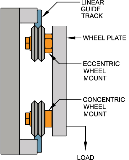

Wheel-plate configurations: How to properly design a wheel plate
In designing a wheel plate, it’s important to use the right combination of eccentric and concentric guide wheels depending on the configuration. The linear system should always have two concentric wheels while the remaining guide wheels should be eccentric. The eccentric wheels eliminate play (clearance) between the wheels and tracks and allow preloading of all the wheels so that they roll smoothly instead of sliding or skipping on the track. If the wheel plate is loaded in the radial direction, the concentric wheel should support as much of the radial load as possible.
Note that the optimal locations of the eccentric and concentric wheels relative to an applied radial load are dependent on whether the tracks are between or outside of the wheel plate’s two rows of wheels.
DualVee-Example-2
DualVee-Example-1
The optimal locations of the eccentric and concentric wheels relative to an applied radial load are dependent on whether the tracks are between or outside of the wheel plate’s two rows of wheels.
Linear guide-wheel bearing preload
Wheel plate preloading creates radial loading between the wheels and tracks that exists when the system is not loaded by another outside force, and serves to eliminate play between the wheel and track.
Preload = Measured wheel plate breakaway force / (# of wheels × Coefficient of friction)
During assembly of the system, the wheel plate should be placed on the tracks, without any load attached, and with the concentric wheels fully tightened and the eccentric wheels tightened just sufficiently to permit adjustment.
Preload adjustment is accomplished by gradually rotating the eccentric wheel bushing(s) until the tracks are held captive by the two sets of wheels on each side of the wheel plate, with no apparent clearance between the tracks and wheels and very light preload. Once this is accomplished, fasten the eccentric wheel(s) so that they hold their positions.
Next, check each wheel for correct preload by rotating the wheel with your fingers, while holding the track stationary. The wheel should skid against the track with a small amount of resistance, but should still turn without much difficulty. If rotation is not possible, the preload should be reduced accordingly by readjusting the eccentric wheel(s).
Caution must be used when applying preload because too much preload on the wheels can cause premature failure. The rated radial load should never be exceeded by the preload and subsequent radial loads applied to the wheel when in service. Note that preloading cannot compensate for large variations in track parallelism tolerances which can occur in long travel length systems.
