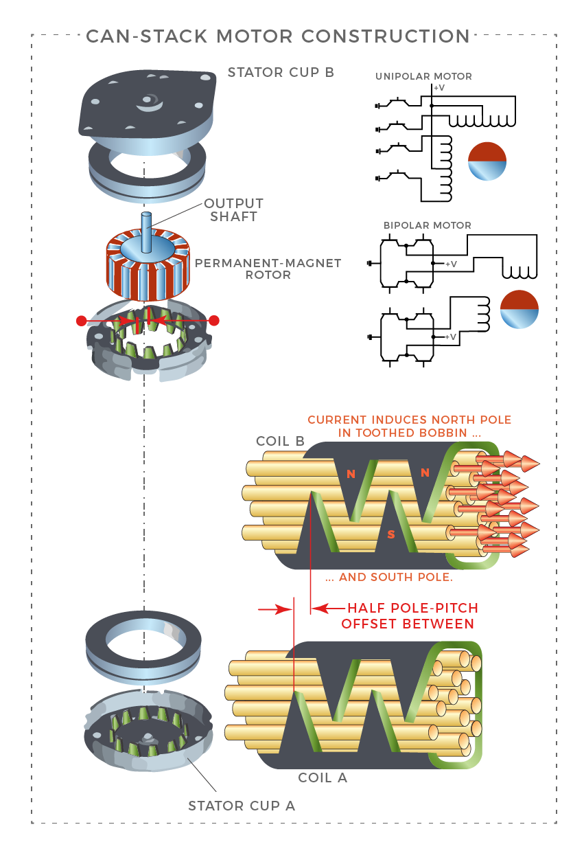

Can-stack linear actuators are one type of stepper-motor design that converts rotary to linear motion with a built-in leadscrew. The linear actuators incorporate can-stack motors — sometimes called claw-tooth step motors, tin-can stepper motors, or claw-pole motors — leverage low-cost construction with punched sheet-metal parts that form toothed (or clawed) cups surrounding bobbin coils.
Common are twin-stator assemblies that deliver two phases for indexed output. Here, the two stators’ claws (teeth) are offset by one-half the pole pitch — 360° ÷ number of teeth ÷ 2. The rotor has an array of permanent magnets and the same number of pole pairs as the coils.

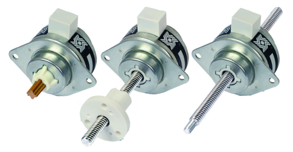

Shown here are Haydon Kerk Motion Solutions can-stack linear actuators available in 36 mm and other sizes. An optimized stator-tooth geometry, neodymium magnets, oversized output spline, and engineered plastics boost performance. Large ball bearings boost rotor support and axial-load capacity. The durable can-stack linear actuators are suitable for medical equipment, barcode scanning, and laboratory instrumentation requiring high force.

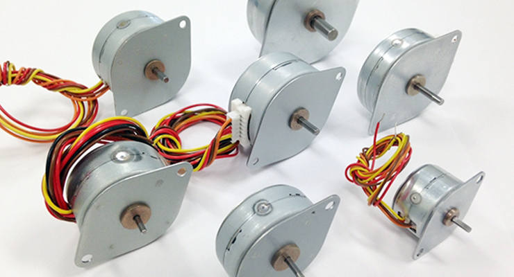

In fact, can-stack motors have become quite common over the last 30 years — especially with the proliferation of higher-volume lower-cost applications in consumer-grade designs and small appliances.

Can-stack motors usually have two-phase construction. Two stator cups have claw-shaped poles (sometimes called teeth) formed around their windings. The rotor is a permanent-magnet design with the same number of pole pairs as each coil. Rotor and stators have an equal number of pole pairs. On a can-stack motor, poles of each stator coil are offset by half the pole pitch. With two coils, this makes for four discrete positions per pole pitch. Case in point: A two-phase motor with 12 pole pairs in each stator coil cup section outputs 7.5° steps and 48 steps per complete revolution.

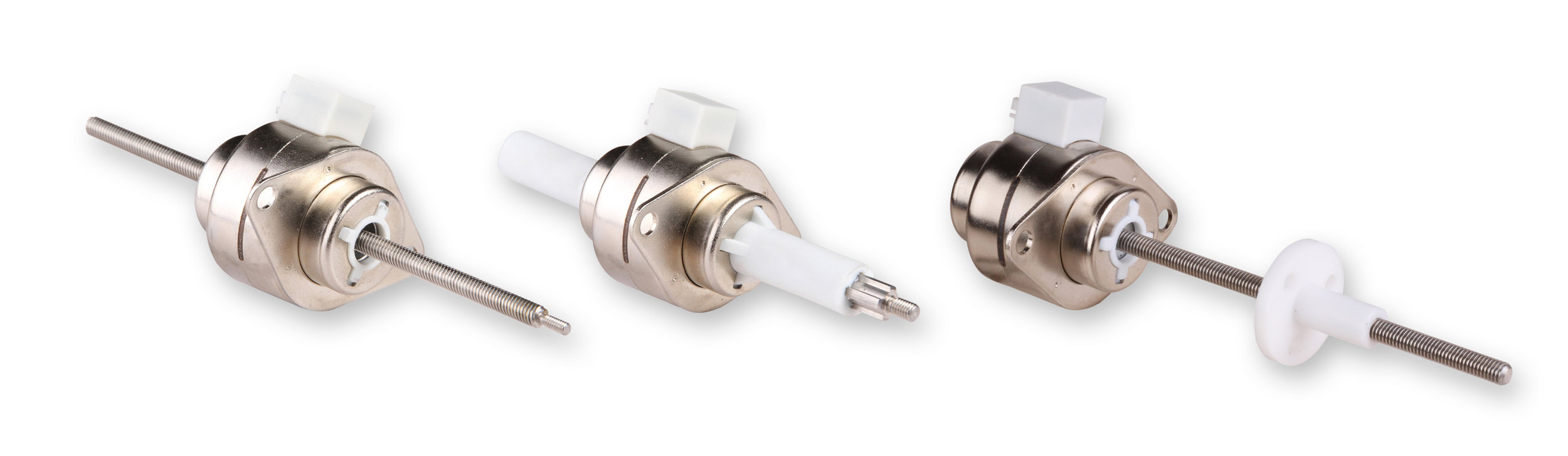

Can-stack motors are simple designs leveraging permanent magnets and stepper-motor operation to deliver motion in small applications needing moderate accuracy and torque. Can-stack linear actuators usually incorporate these motors with twin stators (and coils). Motors with radially magnetized permanent magnets (contrasting with other steppers having axially oriented magnetism) have high torque-to-size ratios — which in turns makes for compact designs. Common sizes are in the 8 to 50-mm-diameter range. Shown left to right here are DINGS’ MOTION USA non-captive, captive, and external-nut can-stack linear actuators.
Consider the common variation with 24 poles in each coil or phase. With 24 poles around 360° the pitch between poles on one stator is 15° — but because half a pole pitch offsets two stators, there are 7.5° between stator poles. That means when the drive energizes stators individually, the motor rotates 7.5° each step. Phase-energization sequence dictates the rotational direction while the pulse frequency dictates rpm. Input pulses dictate rotation length.

Design variations for can-stack motors abound. However, a typical can-stack motor’s bobbin-wound coils are either unipolar or (more common in today’s setups) bipolar to let design engineers pick the most suitable motor for the required electrical input and motor output.
Unipolar motors have two windings for each coil but only use them one at a time. Once the most common, unipolar setups supply unidirectional current into two-phase bifilar windings. Remember here that a bifilar winding is one consisting of two closely spaced parallel windings. Because each motor coil only has one polarity (to act as a north or south electromagnet) they must switch on and off to prompt output motion. This simplifies drive electronics — and helps unipolar motors excel in high-speed applications, because they don’t rely on full winding-current decay before energizing the opposite polarity.
Contrast this with bipolar motors that only have one winding per coil and switch polarity to prompt output motion. Here, current decay must be complete to let polarity switch and motion output. Drive electronics for bipolar motors are slightly more complicated than those for unipolar motors, but they work better on slower axes and high-torque applications.

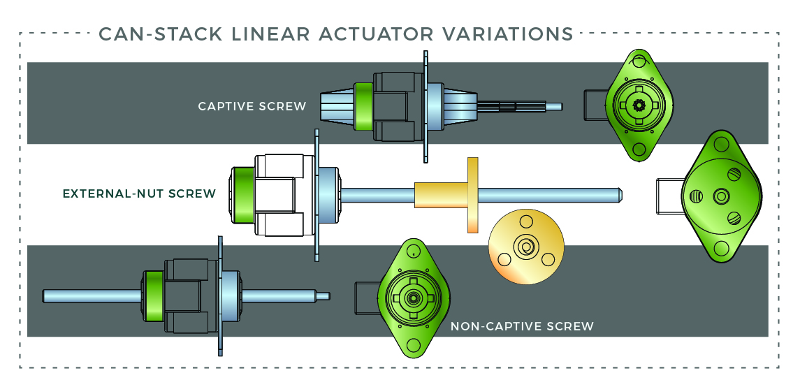

Captive linear actuators have screws held by a device (either internal or external to the motor) that prevents rotation. Non-captive actuators have screws that rotate with the motor — so rotation is typically prevented by the application’s surrounding installation. Non-captive linear actuators excel in long-stroke applications. In contrast, traveling-nut actuators include screws that don’t extend and retract. Instead, the nut (external to the motor) travels along the screw as motor and screw turn together. Some applications for traveling-nut can-stack actuators include collaborative-robot end-effectors; printers; and automated designs for clinical diagnostics. Example geometries courtesy Haydon Kerk Motion Solutions
No matter the features or output-shaft format, three common designs exist for can-stack linear actuators:
1. Captive linear actuators have screws held by a device (either internal or external to the motor) that prevents rotation. One can recognize a captive linear actuator by how the output shaft extends and retracts into the actuator body. Common applications include those in small dispensing machinery and miniature industrial valves.
2. Non-captive actuators have screws that rotate with the motor — so rotation is typically prevented by the application’s inherent design. Non-captive linear actuators excel in long-stroke applications. Some applications include position-ing systems for antenna and laboratory dispensing equipment.
3. Traveling-nut actuators include screws that don’t extend and retract. Instead, the nut (external to the motor) travels along the screw as motor and screw turn together. Some applications for traveling-nut can-stack actuators include collaborative-robot end-effectors; printers; and automated designs for clinical diagnostics.
