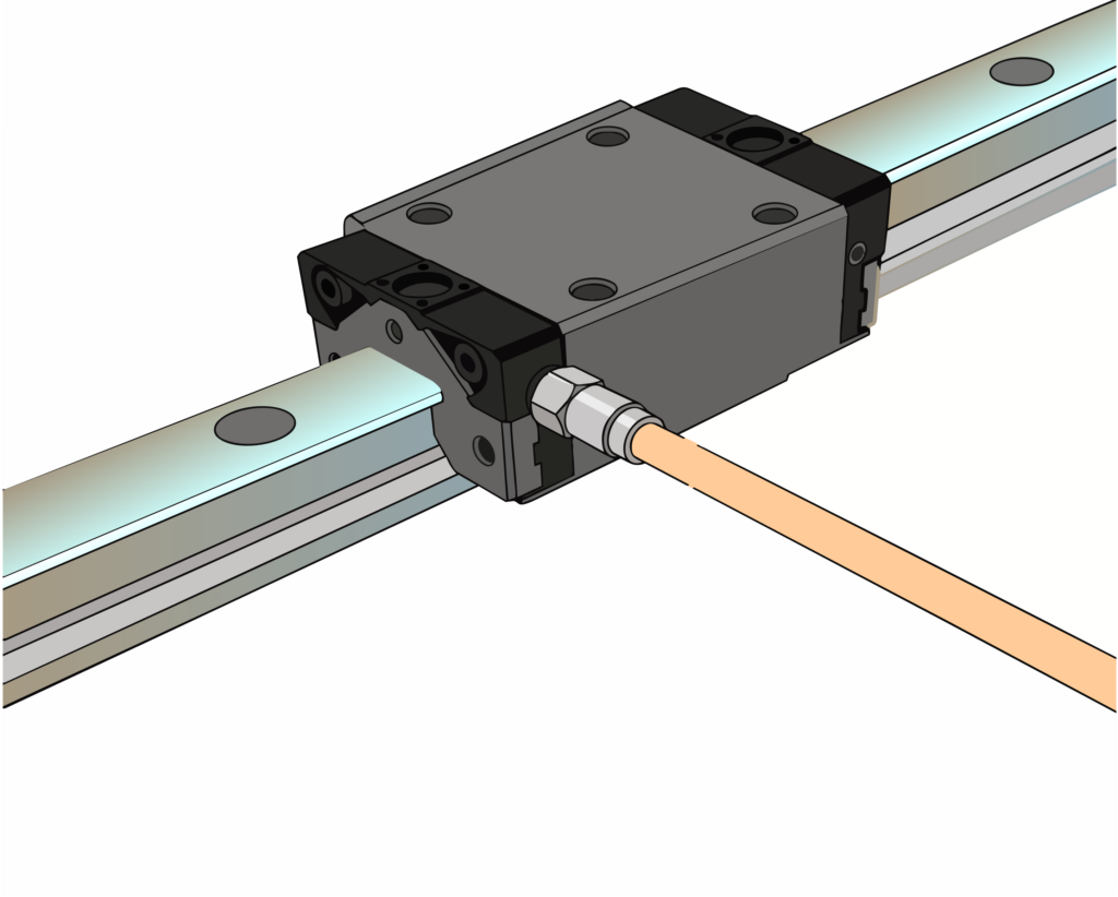

In conventional linear encoders, the readhead connects to the controller and power via cables. The cables to carry the electrical signals (analog or digital) are shielded. The scale mounts in a groove machined into the side or upper face of the rail. The scale may be protected against water ingress, dust, or debris by a cover.
Linear guides with built-in encoders sometimes use flat cabling to the readhead.
Wired linear-encoder technologies are well established in industrial automation. Power is supplied through the same wiring harness used for signal transmission. This proven, reliable technology delivers stable signal transmission that is unaffected by wireless interference, and it is compatible with most standard motion controllers. No batteries are required because power is supplied directly via the cable. As a result, wired readheads remain the conventional choice: a reliable, cost-effective solution offering stable, proven signal transmission and broad compatibility with existing controllers and machine designs.
Linear guides that integrate magnetic encoders for positioning avoid the issues of optical technologies, but most still involve cabling to the guide carriage.
There are limitations and drawbacks to these technologies, though. Cable routing is complex, especially in multi-axis systems or tight installations, and this complexity reduces overall system flexibility. The cables themselves are susceptible to wear, fatigue, breaks, or insulation damage from continuous movement, and long cable runs can also introduce signal noise. Together, these issues increase maintenance overhead. That’s because replacing or managing cables adds both downtime and cost.

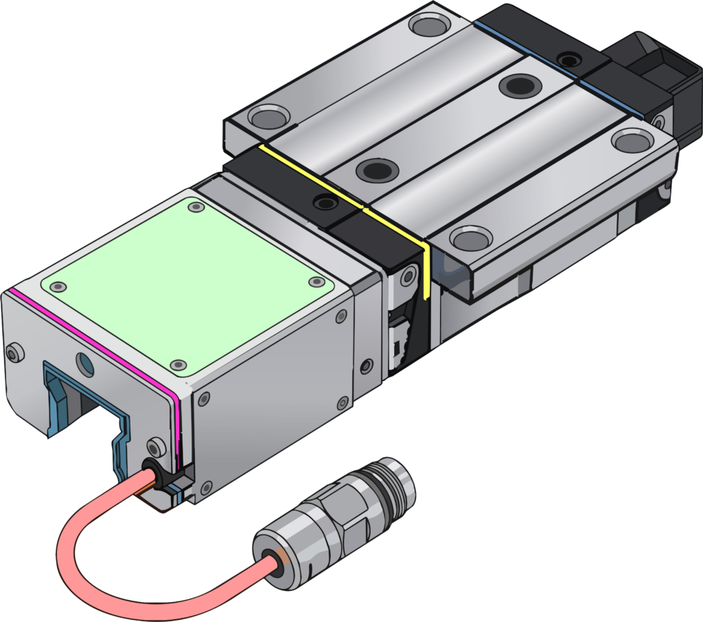

Linear feedback from some manufacturers integrate the readhead and electronics into a single housing mounted on the end of the carriage. No matter how they’re integrated, the readhead detects the scale pattern and converts the signals into usable position data.

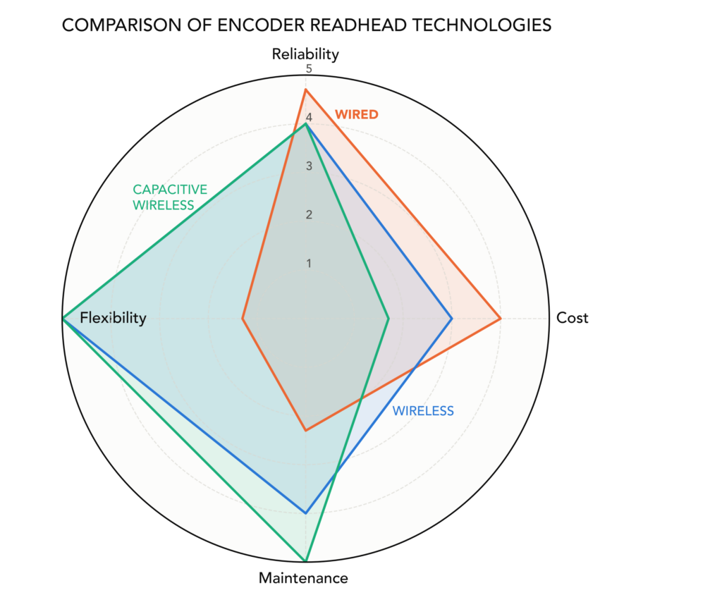

Linear encoders with hardwired readheads excel in conventional CNC machines, on the short axes of precision motion designs, and in systems for which stability is more important than flexibility. In contrast, wireless readheads excel in robotics, equipment for cleanrooms, and long-stroke axes.
More specifically, data transfer occurs via a radio frequency (RF) or optical wireless link. Power is provided through a battery, energy harvesting, or inductive power transfer.

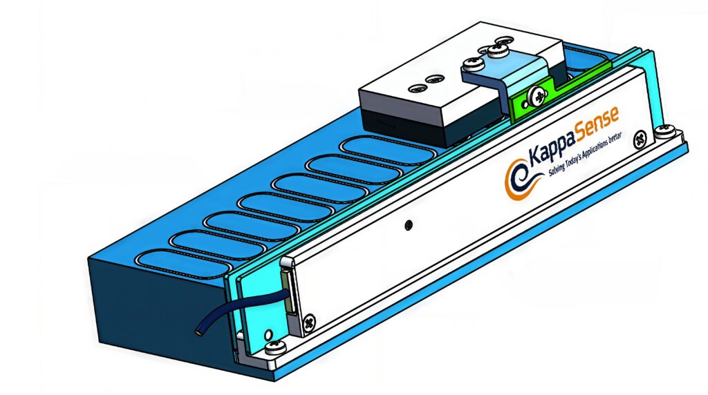

KappaSense linear encoders put the electronics (and cabling) on the static scale and not the readhead that moves with the carriage.
This and capacitive sensing offer several advantages. The overall design can be simpler, because there’s no need for cable carriers, drag chains, or conduits … so axes are more reconfigurable. There are also no cables to wear out or replace. Machine layout is easier and oftentimes the axis assemblies can be more compact than those with traditional encoding hardware. Reliability in tough environments is also higher, as fewer connectors mean fewer disconnect points. All this helps wireless linear encoding support Industry 4.0 and smart-factory initiatives.
KappaSense linear encoders measure capacitance changes between a patterned scale and a sensing readhead (inset — top). Some such encoders can pair multiple independent readheads with one scale to track travels up to 1,200 mm.

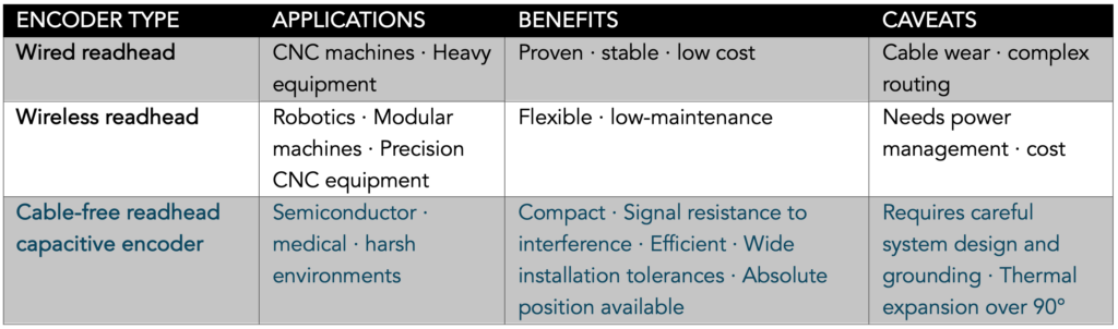

Challenges include potential signal interference in noisy industrial environments, power management requirements for battery-based heads, and higher initial system cost.
Linear encoders with wired, wireless, and capacitive cable-free readheads offer different benefits.
Applications include long-travel moving axes, rotary stages, and modular machine setups. In CNC machines, the technology delivers high precision with reduced wiring complexity. In robotics, it enables flexible integration in articulated arms and linear actuators. In the semiconductor industry, it’s cleanroom-friendly and produces no cable dust or wear. In medical devices, cable-free linear encoder technology offers a compact low-maintenance solution. The technology is also well suited to high-speed automation systems requiring ultra-precise feedback as well as applications that operate in vacuum settings.
