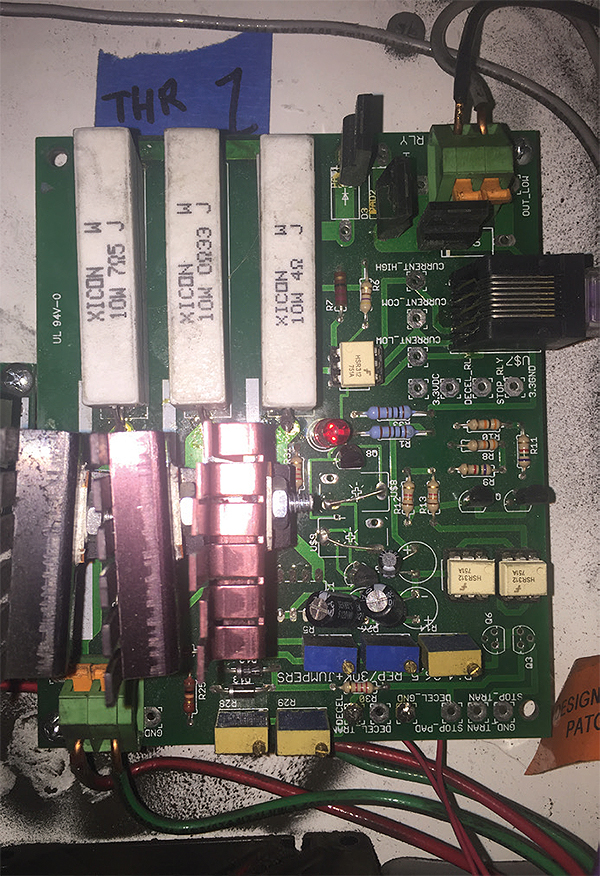

Local volunteers and enthusiasts designed and manufactured the original control system by hand. The custom printed circuit boards with resistors, diodes, transistors, capacitors and other electronic components were all soldered and assembled on site. Each track had its own control panel containing all the parts and pieces making up the control system.
custom-circuit-boards
The original custom circuit boards were difficult to troubleshoot and repair, which drove the facility to seek a better alternative.
A computer ran the original circa 1970s C programming language, written before C++ was even developed. 45 of the control panels were originally made, and more were eventually added to accommodate growth. Power to the trains was regulated with a single capacitor and several transistors.
After running well for six years, maintenance on the original control system became problematic. When parts wore out or broke, they had to be repaired by hand. Replacement parts weren’t available for much of the hardware or components. A more flexible control system was needed for this large distributed control application, and AutomationDirect was selected as the primary supplier.

The old system controlled the voltage feeding the track using analog components, including a combination of NPN transistors, optical amplifiers, resistors and capacitors.

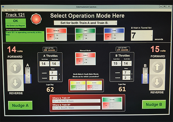

The new control system controls all analog voltages through the PLCs. Each PLC has a built-in web server, allowing speed control voltages and other values to be set using a web thin client running on an iPad or Surface tablet. Acceleration and deceleration rates can also be adjusted, along with many other parameters. The web thin client also provides a comprehensive view of train operation, along with the ability to drill down to more detailed levels as required by the operator. HMI software access through a wireless tablet lets the user be out and about in the layout and watching the results based on the user input, rather than being blind behind the scenes as with the original control system.
tablet-based-HMI-screen
This tablet-based HMI screen enables changes to the PLC settings and programs from any location along the two miles of track.

Analog signals are used to control the voltages supplied to the rails on the tracks, which then power the locomotives and other third rail train equipment. It’s important that trains accelerate and decelerate at certain rates to prevent damaging the locomotives. The PLC’s analog voltage output modules are rated 0-10 Vdc, while the train’s operating voltage is between 0 and 24 Vdc, with an average current load of 2 to 5 A.
Because the analog output module isn’t designed to handle such a load, a custom-designed amplifier board converts the low-level 0 to 10 Vdc output to an amplified, high current 0 to 24 Vdc output. This amplified voltage then feeds a 40-A power transistor that drives power to the locomotives. The power transistor is doing the work of supplying the current to the locomotive, with the PLC simply providing a control voltage that regulates the transistor’s output.
