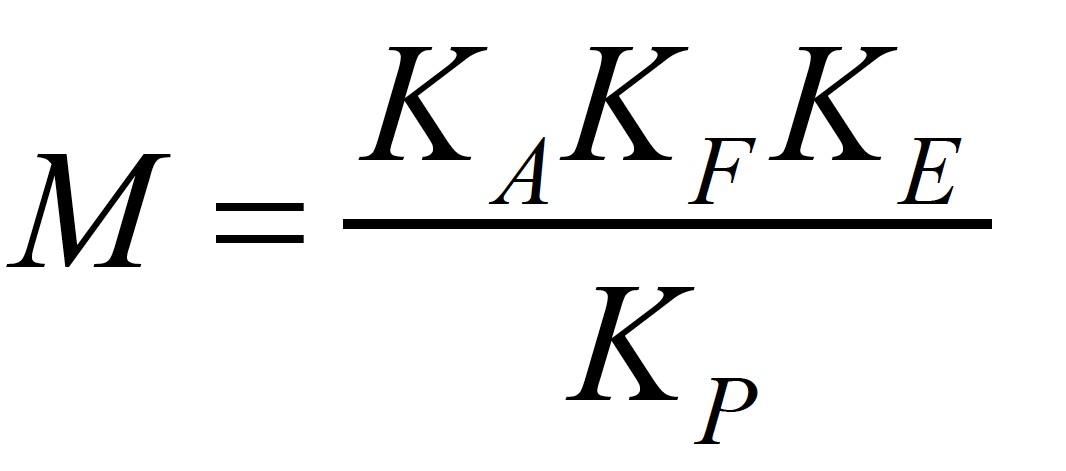

Except for AR and R frequencies, the total actuator mass M can also be calculated from the experimental Bode. Here, the total Plant Gain 20log KP is found from the amplitude Bode at the angular frequency of 1 rad/sec. In fact, we can find three things from motor data sheets and the ACS Motion Control controller we use to explore our example gantry setup:
1) Gains of plant components as current amplifier KA in Apk/bit
2) The motor force constant KF in N/Apk
3) Position resolution KE in counts/m
So total mass M in kg is:
