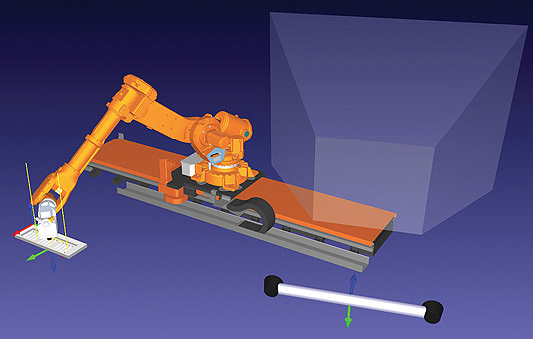

cole-de-technologie-sup-rieure-Control-and-Robotics-Lab
RTUs offer many benefits but complicate calibration. One cost-effective option is photogrammetry-based optical CMM called C-Track and calibration software such as RoboDK (depicting one setup here). Image courtesy Ilian Bonev of the École de technologie supérieure Control and Robotics Lab
