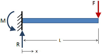

For example, a load applied to an end-supported cantilever beam will cause a reaction force and a bending moment on the beam, but doesn’t change its angular momentum, and and therefore, doesn’t cause the beam to rotate.
cantilever beam reaction forces
A force (F) applied to a cantilever beam causes a reaction force (R) and a moment (M), but does not cause the beam to rotate.

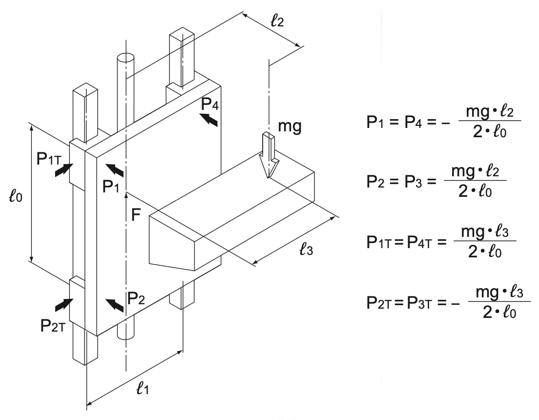

Because moment forces are static — they don’t result in motion — they can be resolved into reaction forces that counteract the applied moment.
moment loads resolved into forces
The moment load on this two-rail, four-bearing system is resolved into radial and lateral loads on each bearing.
