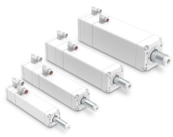

However, if a component or system has integrated electrical equipment and is fully enclosed — an actuator with an integrated motor or integrated motor/drive combination would fall into this category — it will likely be tested for ingress protection and have an IP rating. On the other hand, if an electrical component is merely mounted to a mechanical component — such as a proximity switch on a linear actuator or a linear encoder on a guide rail — with no enclosure covering the entire assembly, the electrical component itself may have an IP rating, but the entire assembly (actuator-plus-sensor or rail-plus-encoder) would not.
