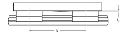

Vertical offset between carriages
Mounting linear guides - carriage vertical offset
Vertical offset between carriages, S2
Image credit Thomson Industries, Inc.
When multiple carriages are used on the same rail, the vertical offset between carriages, often denoted as S2, becomes an important factor and can impart a pitch moment on the carriages. The permissible vertical offset is a function of both the length of the carriages (standard, short, or long) and the distance between carriages.
Similar to the offset between rails, the calculation of vertical offset between carriages should take into account the height difference between carriages, ΔH. If the actual vertical offset is greater than the calculated permissible offset, S2, then a shorter version of the carriages, or a higher accuracy version, must be used.
