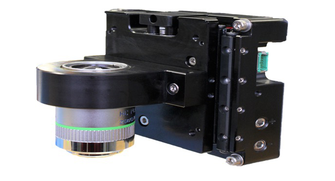

Dover Motion, a designer and manufacturer of motion setups for life sciences and diagnostics instruments, today announced the launch of the DOF-5 Objective Focusing Stage. The DOF-5 is a microscope objective nanopositioning stage optimized for optical imaging applications.
Developed for automated microscope objective focusing applications including next-generation sequencing (NGS), digital cell morphology, and automated digital pathology, the DOF-5 is a demonstration of Dover Motion’s commitment to introducing disruptive innovation into the life sciences and diagnostics industries. The DOF-5 introduces many new features such as greater travel (> 5 mm) and performance improvements over piezo stages. These features are enabling product developers to reach product performance gains, while the lower product cost is revealing new market, product and application opportunities.

The fundamentals of the DOF-5 were guided by Voice of Customer research. In interviewing numerous original equipment manufacturers (OEMs), opportunities and insights were identified and translated into product requirements to deliver a more flexible objective focusing stage. The resultant DOF-5 exceeds the performance characteristics of typical piezo-based stages and includes the following additional features and functionality:
- crossed roller bearings to remove common issues of flexure bearings which can be susceptible to off-axis motion;
- optical position feedback and servo drive controls integrated directly into the stage;
- embedded controller to reduce system complexity;
- inbuilt design features such as side mounted user adjustable hard stops to precisely set the objective travel and prevent collisions; and
- increased travel (up to 5mm), with higher bandwidth and fast step and settle to provide more engineering flexibility.

“In developing the DOF-5, we overcame the limitations through the application of stiff, crossed roller guideways, combined with an integrated servo drive to provide dramatically increased travel, much higher stiffness, and far shorter move and settle times.”
