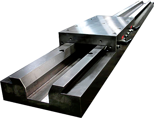

Gilman-dovetail-slide-assemblyDovetail-slide assemblies go into applications that need accurate linear strokes even under complex loading or nonstandard mounting arrangements. Like other linear-motion devices, they have a stationary rail (the base) and a moving carriage (the saddle). What sets these assemblies apart is that the rails have male dovetail geometry that securely engages female saddle geometry for better stability and load capacity than other linear-motion options.
In most cases, both subcomponents are made of close-grained cast iron normalized to minimize distortion. Manufacturers usually machine and grind the saddle and base after assembly, so they are parallel on top and bottom surfaces for better mounting. Then the manufacturer either finishes the way-slide with milling (precise enough for the majority of applications) or hand-scraping to get a lower coefficient of friction and smoother operation (for demanding setups). Installers can drill, tap, or machine the sets to accommodate specific mounting requirements. Standard dovetail-slide sets range from a couple inches to 20 in. wide with saddles to 36 in. long, and bases to 96 in. or longer in some cases.
Gilman-dovetail-slide-assembly-2
Besides the base and saddle, most dovetail slides have four other parts.
• Lubrication fittings. Lubrication is key to fast but precise dovetail-slide operation, so lube fittings are standard on all but the most basic slides for lead-screw-driven axes. Drilled passages in the slides let lubricant get to working way surfaces and reduce friction, in turn extending life. On some slides, the standard passage fittings can come off to accommodate meter fittings of automated lubrication systems. Here, use Mobil Vactra #2 oil (a slideway lubricant specifically engineered with additives for machine tool applications) or an equivalent oil. Do not use grease. Manufacturers publish charts and formulas to help engineers determine the lube area or amount of lubrication a slide needs. This depends partly on the application.
• Gib. This part—a ground low-carbon steel spacer that runs the saddle length—lets users adjust the clearance between the way surfaces, though manufacturers set it at the factory before shipping to suit most applications. Tighter or looser gib settings are usually reserved for specialty applications.
• Gib screws. These are a series of socket-head screws along one side of the saddle for adjusting the gib.
• Gib-screw nut. The gib-screw nut locks the gib screw in place to maintain the adjustment on the gib. Likewise, a gib lock handle gives operators a way to hold the saddle in a target position.

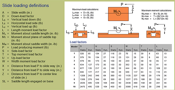

The appropriate slide size for a particular application depends on the loads. Published values are for uniformly distributed loads and moments, and calculations assume the saddle is rigid. Some uses allow higher loads on a given slide—for example, rough machining or positioning applications—while other conditions dictate the use of lower values—precision boring or grinding applications, for example. For saddle lengths longer than two times the width, and if deflections are critical, designers should consult with the manufacturer to get exact load capacities.
slide-loading-definitions
Dynamic load factors for manual powered slides should be cut in half unless low-friction bearing material is used.

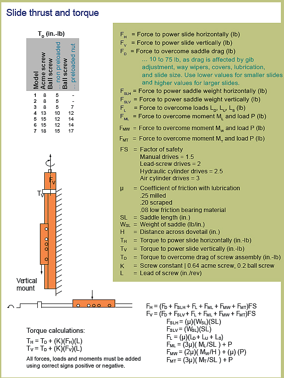

The main considerations are slide thrust and torque. For standard dovetail slides, the force to power the slide assembly includes the force to overcome all external loads related general loading (see the figure illustrating this concept) and the force to power the saddle assembly—all multiplied by a factor of safety. A factor of safety (depending on the drive) ensures sufficient power to move the load and overcome friction, which in turn depends on the effects of lubrication, machining tolerances and finish. Torque to accelerate or decelerate the slide depends on the moving weight, screw size, force applied to the slide and the rate of acceleration or deceleration. Design engineers should get the latter values directly from the manufacturer of the motors they pick.
slide-thrust-and-torque
Engineers that get thrust values from calculations should check them against the maximum thrust capacities of the design’s drive model. If acceleration time is critical or the machine needs speeds above 350 ipm, the design may need a custom setup.

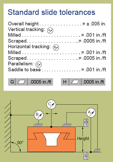

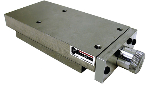

The most basic option is a low-profile slide assembly, useful where loads are moderate and the application needs a compact design. These basic assemblies, with way surfaces that are milled or scraped, are for end users that will engineer their own means of movement and mounting.
Slightly more complex are low-profile lead-screw assemblies, which come in myriad configurations. These are suitable for manual positioning—featuring a lead screw, graduated micrometer dial measuring 0.001-in. increments of saddle travel, and custom drive ends. One option has a balanced crank handle so operators can easily retract and advance the saddle; another more compact design has a knurled knob. Acme-screw models with either an in-line or right-angle drive are other options for simple applications. These have gib-lock handles, micrometer dials, needle-bearing thrust assemblies and bronze nuts.
standard-slide-tolerances
Higher accuracies are possible on pre-engineered dovetail-slide systems.

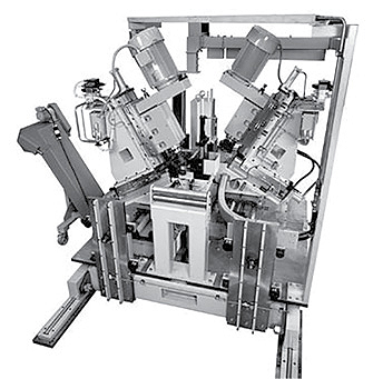

In one real-world application, a processor of coiled metal wanted to reduce handling time and automate machining operations, but process several different widths and thicknesses of material and hundreds of different milling patterns to make thousands of products.
Originally, milling operations happened after material was cut to length. But analysis of downstream jobs showed it would be more efficient if the machine milled the parts before the material was cut off the coil. Now, a new machine positions lengths of material still connected to the coil, then mills it into specific patterns. That lets the company eliminate handling and fixturing for machining pieces already cut to length.
Gilman-application-dovetail
This machine continuously processes coil material that moves through it. A belt-driven spindle powers each milling head, which is fed into the material by two hardened way slides. A manual dovetail slide positions the modules for processing different material coils.
The new machine tool has five adjustable axes to continuously process material strips. A multi-tooth milling head feeds into the material in two axes. Then the material passes through the machine and into the milling head to a set length. Belt-driven spindles mill the surfaces. Hydraulic cylinders control the Y and Z axes hardened-way slides feeding the spindle. The X axis is a dovetail slide used for manual adjustments of the two spindles relative to each other. The fourth and fifth axes are for adjusting milling angles and material widths.
More specifically, the machine uses two Gilman HWS12-12-21-H2-3 slide assemblies with hydraulic cylinder drives; two HWL12-22-30-H3-5 slide assemblies with hydraulic cylinder drives; two DC16-19-36-M-E1-15 slide assemblies with acme screws and right-angle hand wheels; and two motorized 6500C-X2M-50-SB3 belt-driven spindles. Compared to previous setups, the new machine eliminates hundreds of complicated and error-prone operations. That boosts productivity and let the end user expand product offerings.
