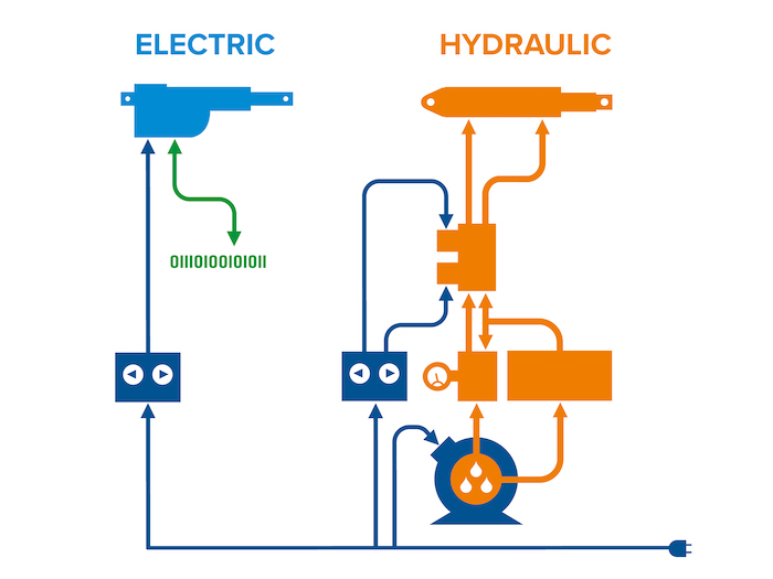

electric actuators
Installation, connection, and maintenance of electric linear actuators are significantly simple compared to hydraulic systems, which require a complex series of pumps, hoses, and other parts to operate. (Image courtesy Thomson Industries, Inc.)
4. Install and connect the electrical components
Installation begins with removing the hydraulic support infrastructure. You’ll no longer need those pumps, cylinders, hoses and other equipment that were needed to support the hydraulic fluid, or the fluid itself. You will, however, still need a charging station, so be sure that it will comply with your battery voltage and type choices.
Once the charging process is set, you can install the actuator, battery, controller and wiring. Although space requirements for the hydraulic cylinders themselves are comparable with electric actuators, you may need to fabricate custom mounts or brackets.
5. Test and optimize the conversion
Connect the electrical components, ensuring that all connections are secure and properly insulated to prevent electrical issues. Test conversion to ensure that all components are functioning correctly, and then calibrate the system to optimize performance and ensure safety.
