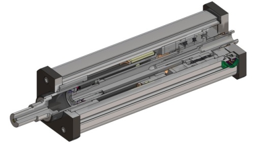

Exlar is extending the capabilities of its high torque, long life Exlar GSX and I Series of electromechanical linear actuators with the introduction of an integral force measuring option. Force measuring is achieved by means of a load cell embedded within the actuator. This option offers a direct method for obtaining electronic data relating to the force being applied by the actuator. The
strain gauge load sensor is mounted inside the actuator’s case in a compact and protected robust design.
The integrated load cell option is available on Exlar’s GSX30, 40, 50 and 60 models, and the I Series 30 and 40 model actuators. The load cell is a strain gauge type, offering stable and accurate load sensing (+/- 1% linearity, +/- 0.5% repeatability and hysteresis) in compression and optionally tension, and for static or dynamic loads.
The force measuring option is provided with a separate connector for interfacing the internal load sensor to an external strain gauge conditioner/amplifier required to excite the strain gauge sensor. In addition, Exlar offers strain gauge conditioners to provide a high level signal, either 0-10V or 4-20mA output, for monitoring of the output signal, which are compatible with most standard PLC
analog input cards and signal conversion modules. Alternatively, any one of numerous PLC strain gauge input cards or separate strain gauge conditioners/amplifiers on the market can be used.

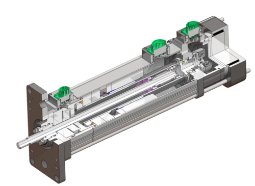

The GSX and I Series actuators in which the force measuring option is available both employ Exlar’s planetary roller screw technology. For the last 18-years, this has been the integral component in creating the most reliable, long lasting electro-mechanical actuators on the market, providing a long-life, all-electric replacement for hydraulic cylinders in thousands of applications world-wide.
The GSX actuators also benefit from Exlar’s T-LAM™ technology, a segmented lamination stator design that enables 35% more continuous motor torque to be provided from the same frame sizes as competitive products, with no cost premium.
The brushless servo design of the GSX series linear actuators allows them to be used in state-of the art closed loop servo systems where electronic control of positioning and velocity is required.
