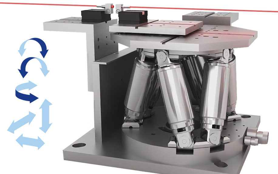

Physik Instrumente (PI) now sells an H-811.F2 high-dynamics hexapod. Designed for photonics alignment applications, the hexapod provides six degrees of freedom, actuator resolution of 5 nm, and repeatability to 60 nm … at speeds to 20 mm/sec. Bearing loads to 5 kg, the hexapod features a removable magnetic kinematic plate to accelerate workflow with fiber-optics components. Travel is to 34 mm and 42° of rotary motion.
