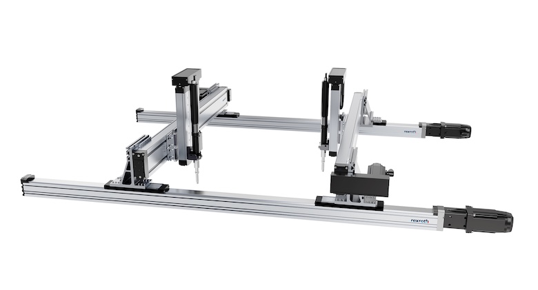

This linear robot has two YZ guideways that enable peak values to be achieved in terms of speed, precision, and repeatability. Image: Bosch Rexroth

Module and pack assembly benefits from high-performance linear guides, which can be combined to form ready-to-use linear axes and Cartesian robots. Compared to industrial robots, linear robots often boast higher precision, dynamics, and compactness due to their mechanical properties. Their range of applications covers handling, screwing, and dosing processes as well as camera transport in end-of-line testing.
Engineers can use Bosch Rexroth’s e-tools to select, size, and configure components. With the Smart Function Kits, pre-installed user software can reduce commissioning and program time. The company also creates customer-specific solutions, such as gantry robots for loading, filling, sealing or gluing, screwing or welding.
