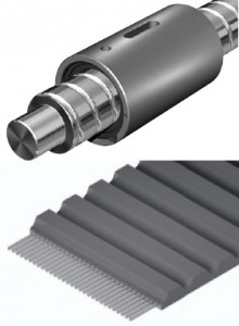

The first step in narrowing down the field is to choose which drive mechanism is best for your application.  Most manufacturers offer at least two drive options, with toothed belt and ball screw being the most common, while pneumatic and linear motor drives serve niche applications.  Below are five factors that will help guide your choice between the two most common types of actuator – toothed belt and ball screw.

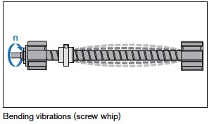

The distance the actuator needs to move in one direction, known as the stroke length, is the first requirement to consider in choosing between ball screw or belt drive.  Ball screw actuators are commonly found at lengths of 1000 mm or less, although larger diameter ball screws can be used at lengths up to 3000 mm.  This limit is governed by the screw’s critical speed.  As a screw’s length increases, its critical speed, or the speed at which the screw begins to encounter bending vibrations, decreases.  Simply put, as a screw gets longer and turns faster, it begins to “whip” like a jump rope.

Screw Whip

As mentioned above, in a ball screw drive actuator, as the length increases, the critical speed decreases.  In general, ball screw actuators can reach speeds up to 1.5 m/s at stroke lengths less than 1 meter.  Ball screw supports can provide additional rigidity by reducing the unsupported length of the screw, allowing the actuator to reach higher speeds and longer lengths.  When considering ball screw supports, consult the manufacturer for assistance in performing the necessary speed and length calculations.

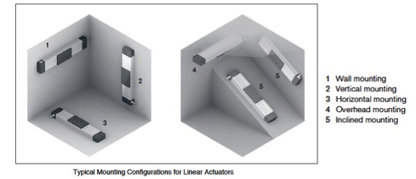

In some cases, the direction in which the actuator is mounted will dictate which drive mechanism is best.  Both belt and ball screw drives are suitable for horizontal and inclined mounting orientations, but applications that require vertical mounting need more careful evaluation.
While every system that is moving a load vertically needs built-in safety mechanisms, ball screw drives are often seen as safer than belt drives for carrying vertical loads.  This is because ball screws, depending on the load, screw lead, and friction in the system, are reluctant to back drive, or “free fall” if there’s a failure of the brake or catastrophic damage to the system.  When a belt drive actuator is required in a vertical application, an external brake or counterweight should be seriously considered.
Mounting

Screw vs Belt Comparison
Both belt drives and ball screw drives have performance benefits.  When making an initial selection, remember that belt drives are typically the better choice for long stokes and high speeds, while ball screw drives are better for applications that require high repeatability or vertical mounting.  In some applications, either drive mechanism will meet the criteria outlined above.  In these cases, the manufacturer can guide you in choosing the right actuator based on more advanced factors, such as acceleration, settling time, or environmental conditions. ⚙️ Illustrations courtesy Bosch Rexroth Corp. used by permission.
