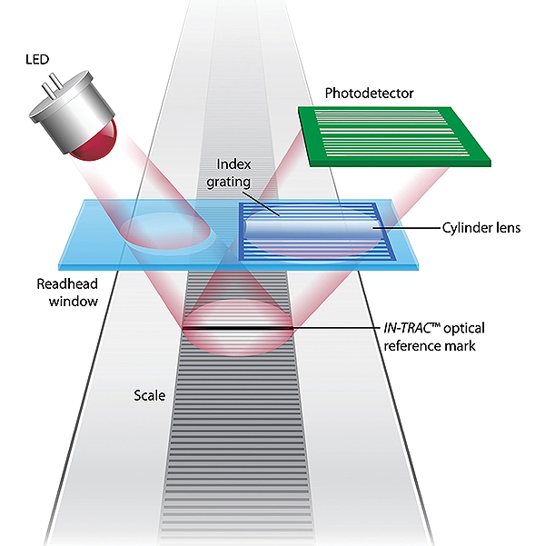

TONiC-Encoder-system-Renishaw
The measurement principle of the TONiC encoder system from Renishaw is optically based. Design features such as filtering optics to support good signal stability and substrate materials optimized to minimize errors from thermal effects improve performance in high accuracy applications.

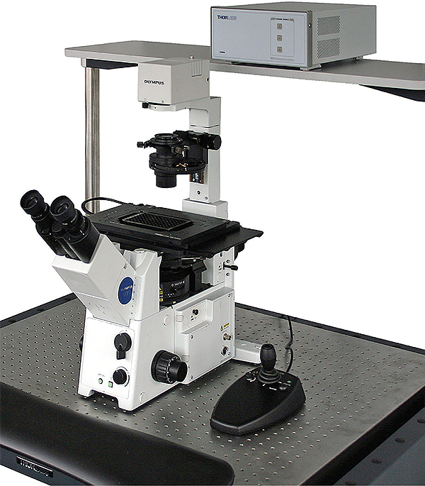

In Thorlabs’ case, the Renishaw linear encoders met the design specifications for high-performance motion control. For instance, the company’s DDS600 low-profile stage requires high-speed translation with high positional accuracy and is designed for surface mapping and characterization applications where there’s a need to move a camera or probe at constant velocity while simultaneously capturing data. And the company’s MLS203 X-Y scanning stages are drop-in replacements for the manual stages found on select microscopes, providing motorized X-Y positioning of microscopy samples. The MLS203 is compatible with inverted and upright microscopes from Nikon, Olympus and Zeiss. Optional adaptor brackets allow integration with other microscopes, optical tables and custom-built applications.
MLS203-x-y-scanning-stage-Thorlabs
MLS203 x-y scanning stages from Thorlabs feature a minimum 100-nm step size and a maximum speed of 0.25 m/sec.
