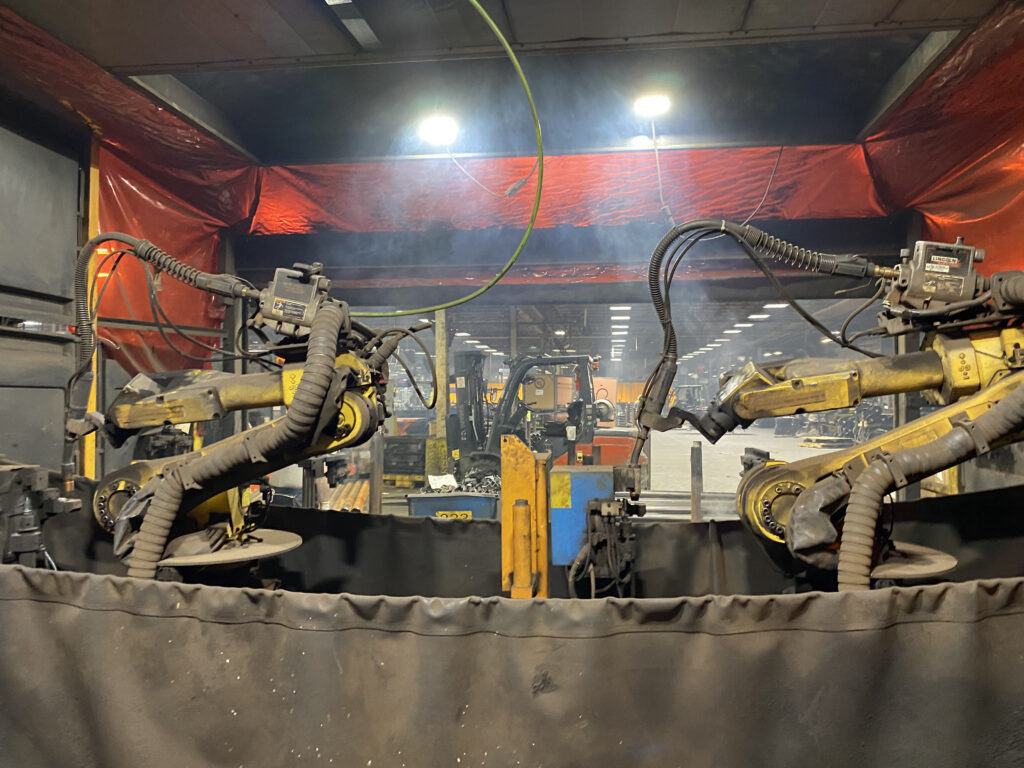

Welding line robots are often exposed to weld spatter, smoke, and fume particulates that leave behind soot and oxidation residue. Image: Wire-Wizard

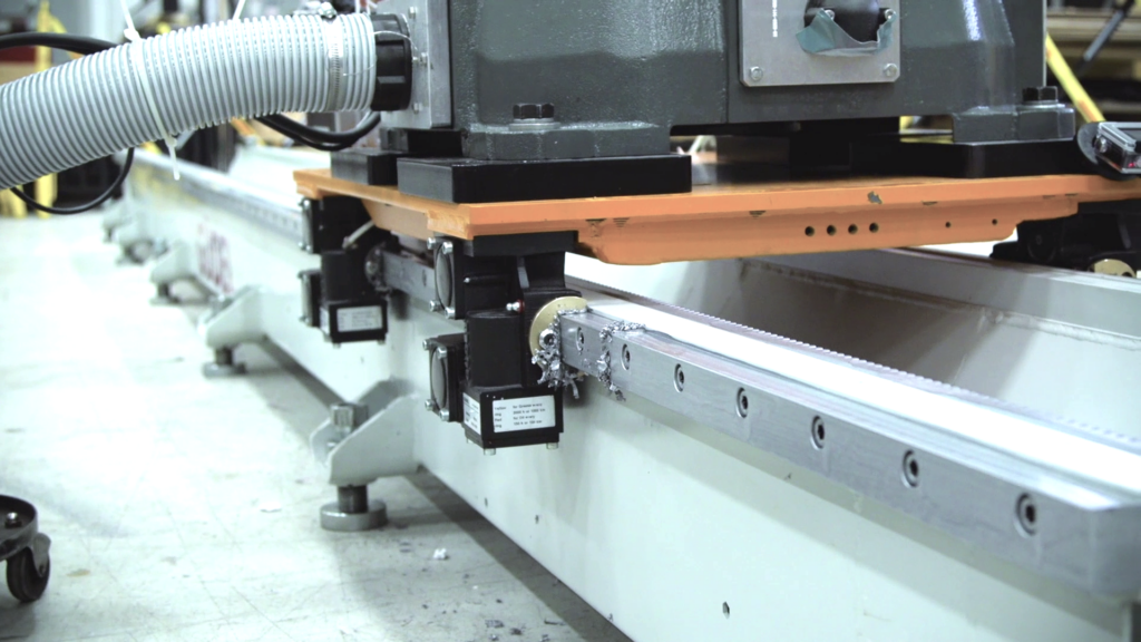

There are two types of bearings deployed in RTUs and gantry robots: Linear bearings with profile guideways and cam followers. Linear bearings consist of a series of small recirculating round or cylindrical bearings in a linear housing that continuously cycles through a load-bearing zone and loops back around as the housing travels. The issue with this design in harsh environments is that small particles can easily enter the housing and cause the linear bearing to lock up and freeze.
This is the carriage from a Güdel linear guide that operates in a stamping plant. Metal shavings and contaminated lubricant cover equipment, but the linear guide’s rail is regularly wiped clean by its bronze scraper. Image: Güdel
The small exposed bearing rollers of this linear profile bearing are easily compromised by the ingress of dirt and debris. Image: Güdel
In RTU applications, the mean time to repair or MTTR for a profile-guideway linear bearing failure is considerable. First, the robot must be removed from the carriage, which may need extensive rigging in a crowded work cell. Next, the carriage must be removed from the track, including disconnecting cables and pulling the motor. After the failed bearing is replaced, the RTU is reassembled and all the robot points must be validated and possibly corrected.

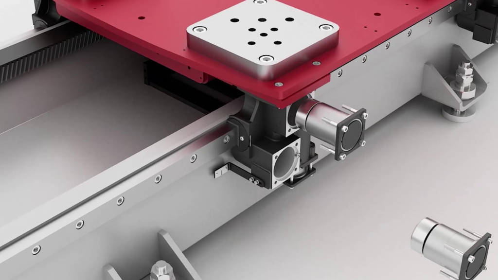

In contrast, some rugged designs pair cam followers with flat rails for the linear-bearing function. Here, an array of cam followers mount into a precision-machined cast carriage housing. The bearing elements are inside roller cartridges inserted into the cast housing. Brass scrapers and felt wipers clear debris off the rail, and any small particles that pass through are simply crushed and cleared. Because the bearings are sealed in rollers, they are never exposed to any contaminants.
Güdel’s core bearing technology uses cam followers mounted into a precision machined cast housing for all RTU and gantry robot models. With their fully enclosed bearings and larger rolling elements, cam followers are much more resilient to harsh industrial environments than linear profile guides. Cam followers’ larger internal cylindrical rollers and large outer race let them simply roll over debris. Image: Güdel Inc.
The roller-bearing cartridges inside the cam followers are quick to adjust and replace if needed. In addition, the RTU carriage can be in any position on the track, and there’s no need to remove the robot or carriage during servicing. MTTR is measured in minutes not days or hours as is common with RTUs relying on profile-guideway linear bearings.

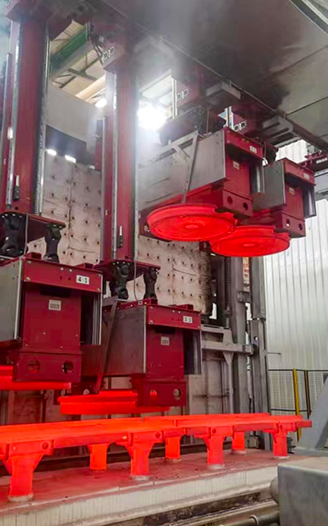

Some Güdel gantry systems are used to transfer red-hot railroad wheels weighing upwards of 1,500 lb each. Image: Güdel

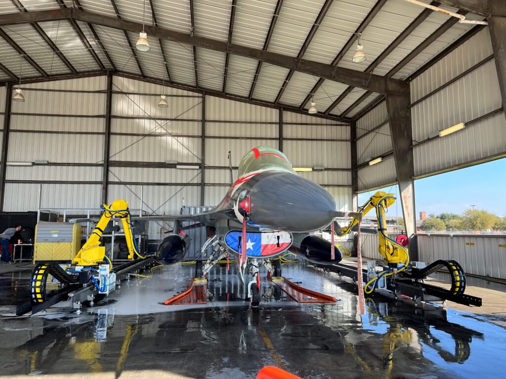

RTUs and gantry robots are also deployed in aerospace, military, and heavy-equipment washdown applications. Often, cleanup occurs after a craft or vehicle has operated in a harsh setting … for example, over oceans where salt condensation can occur. In other applications, the cleaning might be immediately prior to a painting process.
RTU and gantry linear motion based on cam followers having sealed bearing cartridges is suitable for these wet environments. For pre-paint cleaning routines, the bearings’ linear rails and drive rack is (to prevent contaminating the paint surface) run without lubrication.
Robotic jet washing exposes equipment to moisture and harsh chemicals. Image: Wilder Systems Inc.

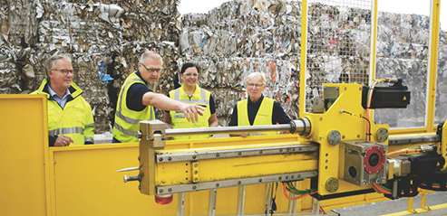

Outdoor recycling equipment can be exposed to the elements — rain, sunshine, and snow. Image: Güdel
Emerging applications include the 3D printing of houses and other structures; field assembly of modular building sections; concrete finishing, cutting, and drilling operations; and recycling and recovery public works.
