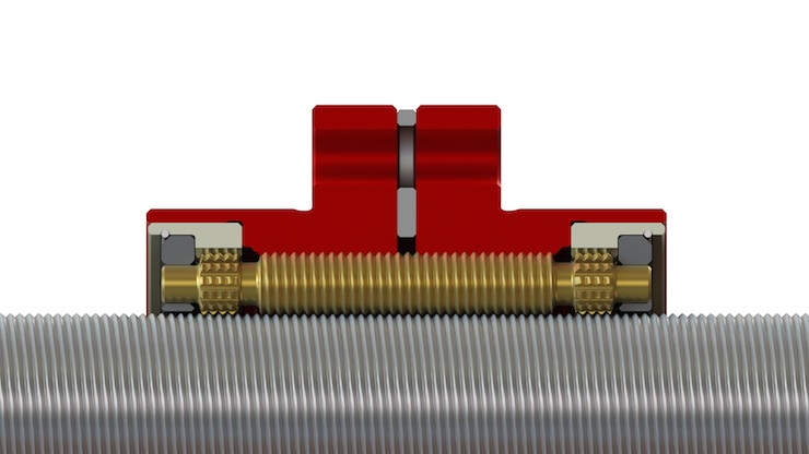

Planetary, or satellite, roller screws are the most familiar design, consisting of a screw, nut, and satellite rollers, all of which have triangular threads with matching helix angles. The screw and nut have multiple-start threads, while the rollers have a single-start thread.
roller screw
Rollvis RV type planetary roller screws and RVR type recirculating roller screws are manufactured with the same grinding accuracy and, therefore, have the same preload capabilities and the same axial play and repeatability specifications. The RVR recirculating type has higher accuracy due specifically to its operating principle, rather than to any differences in manufacturing.
The nut has a roller ring and a geared wheel at each end, and the ends of each roller have cylindrical pivots and gear teeth. The pivots of the rollers are mounted in the holes of the roller ring, ensuring the rollers remain equidistant. The gear teeth on the ends of the rollers engage with the gear wheels at each end of the nut, which guide the rollers parallel to the axis of the screw. Note that in this design, there is no axial movement between the rollers and the nut, so the rollers don’t need to be recirculated.
The curvature of the rollers gives them much larger contact areas than that of the balls in a ball screw, and roller screws typically have more contact points than ball screws. Together, these features allow planetary roller screws to withstand much higher loads than ball screws. This higher load-carrying capacity is often cited as their main advantage, but having larger contact areas also gives roller screws better rigidity and less deflection than similarly sized ball screws, making planetary roller screws ideal for grinding applications. And despite this large contact area, the crowned profile of the rollers means that efficiency is nearly the same as that of a ball screw.

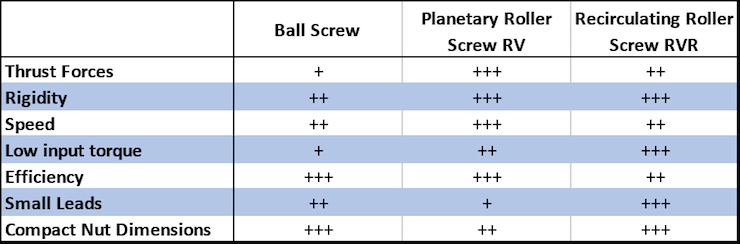

With rollers as the load-bearing elements, both traditional planetary roller screws and recirculating roller screws provide high load capacities and excellent rigidity. The key difference is that recirculating designs – because they require only a single- or double-start screw thread – can be manufactured with fine leads, even with large screw diameters. Some recirculating designs even have fractional-millimeter leads (0.25 mm, for example). And with a fine lead, the required input torque is minimized. The trade off, however, is that recirculating roller screws have lower speed and acceleration capabilities than traditional planetary designs.
Performance comparison of ball screws with roller screws.
