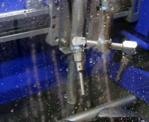

Inside the TourSpin Club Washer, spinning Venturi nozzles (mounted on linear-motion actuators) blast the clubs with high-pressure water … which safely removes dirt from all the clubs’ grooves and soles. This is better than towels that can’t clean grooves and wire brushes that scratch.
The machine uses SIMO Series linear actuators from PBC Linear to move the Venturi nozzles back and forth over all the loaded clubs. The actuators can handle the repetitive washdowns inside the station — as well as the grass, dirt, and sand that splatters off the clubs inside during cleaning.
They also withstand both indoor and outdoor environments. Plus the actuators output high speed and quick direction changes — and more than 50 in. of travel. The designers at Riveer picked the actuators for these design features as well as the SIMO line’s wide array of bearing and drive types.
The SIMO Series in the Club Washer is part of the machine’s core. It uses a cam roller carriage as well as stainless-steel raceways and V rollers. Stainless extends life in the washdown environment, while V rollers help push contaminants off the raceway. A system cover helps protect the actuator from large or avoidable contaminant buildup.
