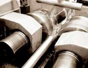

The rolling process forces round screw stock through dies that form the threads by pushing material out of the way.

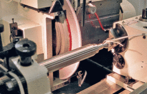

Grinding cuts away material in the screw stock in order to form threads.

For ground ball screws and equipment such as a tub grinder system, both thread grinding and journal grinding are done using the same reference centers, making it easier to minimize radial run-out and to keep the screw threads and end journals concentric.

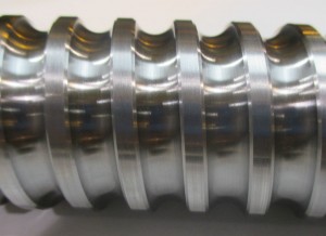

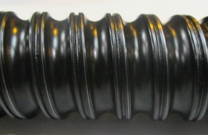

The grinding process produces a very smooth surface finish, and in theory, the rolling process does as well. But in reality, screws that are rolled must also be polished in order to remove an oxidation layer that forms during the rolling process. So when considering surface finish, the comparison is not between the ground surface and the rolled surface; it is actually between the ground surface and the polished surface of the rolled screw. The quality of the polishing step, and not the rolling process, determines the surface finish quality of a rolled screw.

Threads of a ground ball screw.

Threads of a rolled ball screw.
