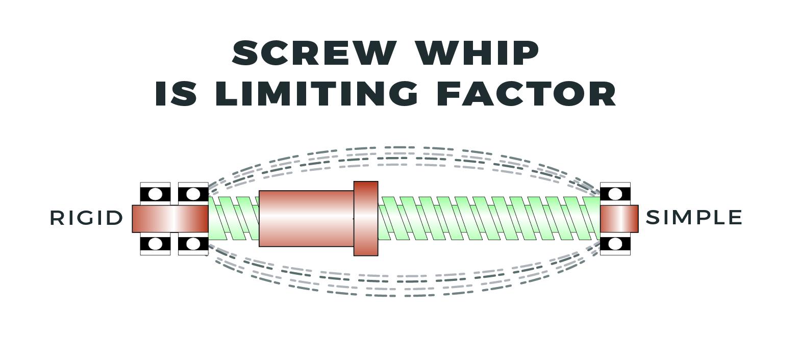

Speed is primarily dependent on the linear drive mechanism
The limiting factor of a linear actuator’s speed capability is typically the drive mechanism.
bending vibrations due to screw whip in high speed linear actuators
These are bending vibrations due to screw whip. Image credit: Bosch Rexroth
Ball screws and lead screws are limited in speed by their tendency to whip, which is a function of the screw diameter, length, and end bearing arrangement.
Because lead screw designs are based on sliding contact and generate high heat due to friction, they often have lower maximum speeds than ball screws of a similar size. So of the screw technologies, actuators based on ball screw drives are more likely to be deemed “high speed” than those based on lead screw drives.
screw whip is limiting factor in high-speed-linear-actuators drive mechanism
Ball screws and lead screws are limited in speed by their tendency to whip — which is dependent on the screw diameter, length, and end bearing arrangement.

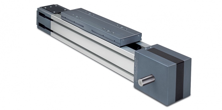

Slider or carriage-type actuators (also called rodless actuators) can achieve even higher speeds than rod-type actuators in many cases. But since their primary uses are for positioning and transport, typically with high loads, they are less often marketed as high speed. Rodless or slider-type actuators have a wide range of drive options, including lead screw, ball screw, rack and pinion, belt, and linear motor.

Linear motors inherently provide the highest speed capabilities, with no mechanical parts to limit speed or create friction and heat. But when incorporated into a linear actuator, linear motor drives are limited by the speed of the guide mechanism. Similarly, steel reinforced belt drives can achieve speeds greater than 12 m/sec, but like linear motors, are limited by the maximum speed of the guide. The most common guide systems used with linear motors and belt drives are recirculating profiled rail bearings, whose maximum speeds typically reach up to 5 m/sec. limiting the overall speed of the actuator to 5 m/sec or less.
Rodless or slider-type actuators that use a belt drive and cam roller guideways can achieve the highest speeds, at up to 10 m/sec.
Image credit: Rollon Corp.
However, higher speeds can be achieved when belt drives are paired with cam roller guides instead of recirculating profiled rail bearings. With preloaded cam roller guides and a properly tensioned, steel-reinforced belt drive, these high speed linear actuators win the race, with travel speeds up to 10 m/sec.
