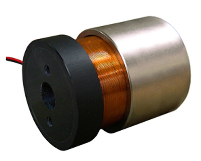

Hollow-core linear voice coil servo motor features 19.1 mm stroke, high force-to-size ratio
The HVCM-051-032-013-01 Linear Voice Coil Motor from Moticont features a high force-to-size ratio and a 19.1 mm (0.75 in.) stroke. The motor is a low inertia, high acceleration/deceleration, high speed, clean and quiet, non-commutated, hollow core brushless servo motor.
A true dc servo motor, it can be used to achieve resolutions of less than 1 micron when used in closed-loop servo applications, and has smooth, zero cogging and zero backlash when connected directly to a load. Additionally, this voice coil or moving coil actuator has a high force to size ratio of 28.2 N (6.3 lb.) of continuous force and a peak force of 89.9 N (20 lb.) at a 10% duty cycle.
voice coil actuator
The 12.7 mm (0.50 in.)  open aperture of the HVCM-051-032-013-01 Linear Voice Coil Motor allows for optics, illumination, laser beams, or passage of cables and the extended length of the motor is 54.5 mm (2.15 in) at mid-stroke. Two threaded mounting holes on 25.4 mm (1.000 in) bolt circles in the 31.8 mm (1.25 in.) long housing and coil ends allow for flexible and easy integration into new and existing applications.
If a longer stroke, higher force, a smaller foot print, servo controller, driver, linear position sensor or customized mounting is required, please consult Moticont’s team of engineers.
The HVCM-051-032-013-01 Linear Voice Coil Motor is suitable for applications such as testing, optical focusing, positioning, laser beam steering, laser drilling, cutting and machining, medical diagnostic equipment, scanning, wafer handling, dynamic vibration absorption, sorting, and assembly applications.
