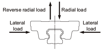

Radial loads: Perpendicular to direction of travel
Like rotary bearings, linear drive terminology defines radial loads as those occurring perpendicular to the axis of motion, in the Y or Z direction. (Note that loads occurring at an angle between the three orthogonal axes can be resolved into components that occur purely in X, Y, or Z.)
Because linear drive mechanisms are only designed to withstand axial loads — not radial loads — they’re typically used in conjunction with linear guides, which support any radial loads in the Y (horizontal) or Z (vertical) directions.
For linear guides, terminology varies when it comes to describing loads acting perpendicular to the axis of motion, depending on the type of guide and whether the load is acting in the Y or the Z direction. For example, because round shaft linear guides have the ability to rotate, the term “radial load” is typically used.
radial and axial loads
Manufacturers sometimes use the term “radial” to describe loads that occur in the vertical direction on linear guides.
Image credit: THK
For non-rotating linear guides — such as profiled rail guides, crossed roller guides, or dovetail slides — radial loads that occur along the Z axis are often described as “normal loads,” “tension loads” (for those in the positive Z direction) or “compression loads” (for those in the negative Z direction)
Loads that occur along the Y axis (horizontal, perpendicular to the direction of motion) are often termed “side loads,” “lateral loads,” or “transverse loads.” It’s important to note that although linear guides are designed to handle loads in both the Y and Z directions, the type of bearing and arrangement of the raceways may lead to different load capacities in different directions.
