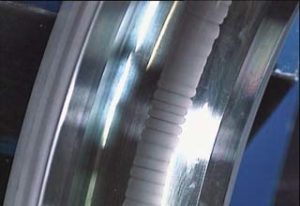

Random electrical currents, which come from multiple sources, such as wiring, insulation, static electricity from operating equipment, and so on, will damage bearings. The damage usually appears on the surface of rings and rolling elements and is similar to that produced by electric arc welding. Either visible regular patterns (flutting) or irregular patterns (pitting), as well as dark or discolored areas, can be signs of electrical current damage. This type of damage will increase bearing noise or vibration levels. If severe enough, the bearings are rendered useless.
The type of electrical current does not matter; alternating current, direct current, and low amperage can damage bearings. How much damage occurs depends on current intensity, duration of the current, bearing load, speed if the bearing is rotating, and lubrication. Rotating bearings are more prone to this type of damage than non-rotating bearings.
The currents tend to heat bearing material to temperatures that melt that portion of the surface, resulting in discolored areas where bearing material was re-hardened or melted, or that produced small craters.
