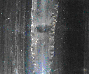

Lubricant prevents metal-to-metal contact, which damages the rolling elements and the raceways. Look for small indentations in the raceways and rolling elements.
Lubricant also keeps temperatures down during bearing operation. Temperature control is critical as high temperatures contribute to bearing seizure where a bearing locks into position and will not move. Another issue with temperature maintenance is the softening of bearing material. Depending on the load, the material will deform if too hot, which results in noise, vibration, and non-smooth movement. Indications of poor lubrication include surfaces with a blue or brown hue, or with a mirror like finish.
Wear caused by vibration: Anytime lubricant is not flowing between the rolling elements and the raceways, a bearing can be damaged. The main cause of such damage when a bearing is not operating is through vibration, either during idle times (normal machine vibrations) or during transportation.
As the bearing experiences vibration, the rolling elements undergo metal-to-metal contact with each other and the raceway, leading to small indentations or depressions in the raceway and small particles breaking away from their surfaces. The resulting damage is known as false brinelling. Damage from balls shows up as sphered cavities, and with rollers it is fluting on the raceways.
