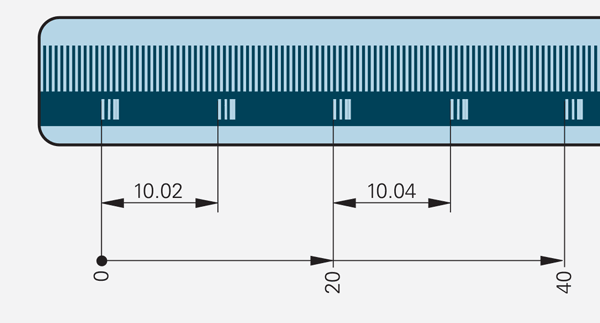

One advantage of magnetic linear encoders over optical versions is that the magnetic tape can be provided in very long lengths — real-world application examples include magnetic scales upwards of 50 meters long. But for incremental encoding, this means the homing sequence to a single reference mark could require traversing the entire length of the encoder. This is why magnetic linear encoders often include distance-coded reference marks. These marks are magnetic poles that are included on the scale in addition to the standard magnetic poles. The reference marks are spaced individually (i.e. their spacing is not the same along the length of the tape) and indepently of the standard magnetic poles. After traversing two reference marks, the encoder can determine absolute position based on the position of the first reference mark, the distance between the two marks, the direction of travel, the length of each magnetic pole, and the basic increment (distance between odd reference marks).
Show here is a method for applying distance-coded reference marks, where the even numbered reference marks shift by 1 grating period, and any two consecutive reference marks that are detected allows the machine control to calculate where the reader head is across the length of encoder scale upon startup.
Image credit: Heidenhain
