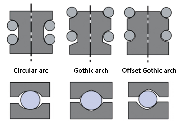

In the context of profiled rail guides with recirculating balls, the raceway geometry defines how the load-carrying balls are positioned relative to the raceways of the rail and the bearing (aka “carriage” or “slide”). The two most common raceway geometries are referred to as circular arc and Gothic arch, but some manufacturers have adopted a third raceway design, referred to as offset Gothic arch. While neither design can be deemed “better” than the others, the raceway geometry affects performance factors such as stiffness, friction, and moment load capacity.

Circular arc raceway geometry provides two-point contact between the ball and the raceways.

Gothic arch geometry provides four-point contact between the ball and the raceways.

Offset Gothic arch geometry provides two-point contact, with an offset between the top and bottom raceways.

Some manufacturers use what is referred to as “offset Gothic arch” geometry. The offset Gothic arch design uses four rows of recirculating balls (two on each side of the bearing) in a Gothic arch geometry, but the centers of the top and bottom raceways are offset. This gives the balls two-point contact (similar to the circular arc design).

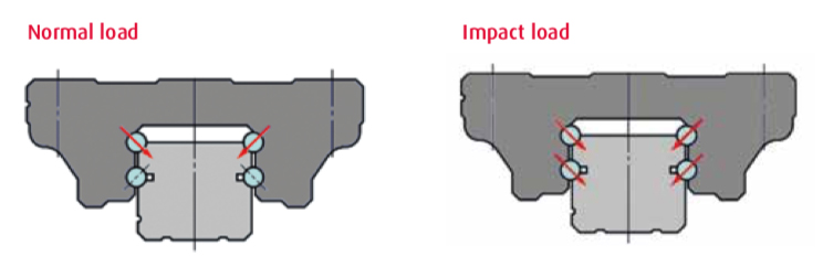

Under normal loading and low preloads, the top rows of balls sustain the load. But under very high loading, or when there are impact loads, the bottom two rows of balls become engaged and provide additional load-carrying capacity. The offset Gothic arch design provides low friction under normal loading, but under heavier loads and higher preloads, rigidity — and friction — are increased.

Under normal loads, the top rows of balls carry the load with two-point contact. But under heavy loads or impact loading, the bottom rows become engaged to help support the load.
