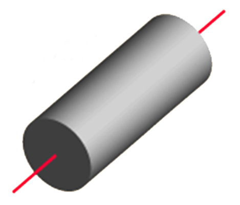

The inertia of a ball or lead screw can be sufficiently approximated by using the formula for inertia of a solid cylinder:
inertia of solid cylinder
The mass of the screw depends on its volume (radius and length) and material density:
mass
V = volume (m3)
ρ = material density (7810 kg/m3 for bearing steel)
And volume is determined by the radius and length of the screw:
volume
L = length (m)
