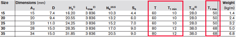

Regardless of the rail length, you should always check the manufacturer’s catalog to find out the pitch of the mounting holes and the minimum distance from the end of the rail to the center of the first hole. Hole spacing among same-sized rails is somewhat standard between manufacturers, but a few suppliers and rail styles deviate from the standard.

To figure out if the required rail length allows the proper dimension between the end of the rail and the center of the first hole, first divide the rail length by the hole pitch. For example, let’s take a size 25 profiled rail with a required length of 1270 mm.
For the size 25 rail, the hole pitch is 60 mm.
1270 ÷ 60 = 21.167
The integer (whole) part of the result tells us the number of complete spaces in the rail. In this case, there are 21 spaces, which means there are 22 holes. The remainder indicates how many millimeters are available on both ends of the rail combined. In this example, there is 0.167 of a complete pitch (60 mm) remaining, which equals 10 mm.
0.167 x 60 = 10
Again, this 10 mm is for both ends of the rail combined, so there will be 5 mm from the center of the last hole to the end of the rail on each end.

For the size 25 rail, the minimum distance allowed at the end is 10 mm, but only 5 mm is available. This is important because using a rail with less than the minimum distance at the ends can result in higher stresses, less holding force, and even failure of those last holes.

Like the minimum distance at the end of the rail, there is also a maximum distance that must be taken into account. If the maximum distance is exceeded, the end of the rail will “cut into” what would be the next hole, due to the diameter of the hole—particularly if the hole is drilled for a countersunk screw. For example, if the hole spacing is 60 mm and the countersink diameter is 10 mm, then at an end distance of 55 mm, the cut will intersect the bore for the screw. Manufacturers typically add several millimeters of safety to protect the integrity of the material at the end of the rail, so the published maximum distance will be closer to 50 mm.
