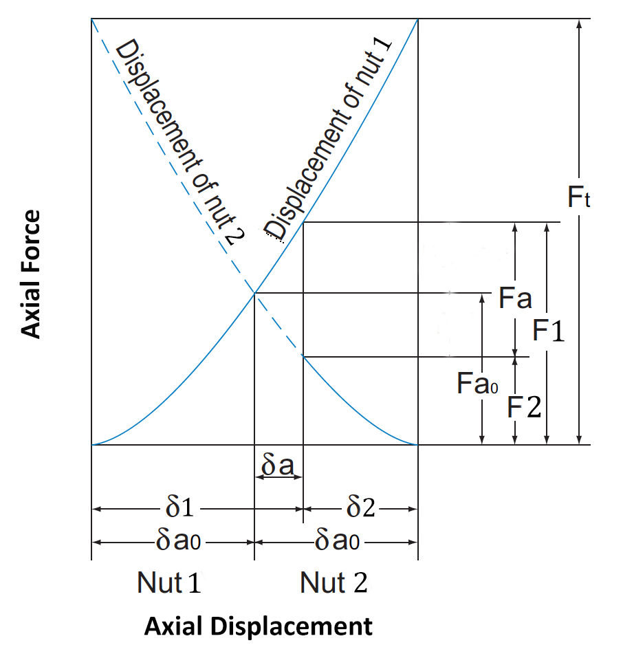

The graph below shows the effects of preload on each nut, in terms of the axial force that each ball nut experiences and the axial displacement of each. The axial displacement values and axial forces are defined as follows:
ball screw axial deflectionδao = axial displacement due to preload
δ1 = total axial displacement of Nut 1
δ2 = total axial displacement of Nut 2
δa = axial displacement due to applied axial force
Fa0 = axial force due to preload
F1 = total axial force on Nut 1
F2 = total axial force on Nut 2
Fa = applied axial force
Preload creates an axial force on the nut (Fa0), which is partially taken by Nut 1 and partially taken by Nut 2. As a result, each nut experiences an axial displacement, δao, due to the preload axial force.
ball nut axial deflection
When an external axial load (Fa) is applied to the screw, the axial force on Nut 1 increases from Fao to F1. On the graph above, if we follow the point where Fa0 intersects the curve for Nut 1, to the point where F1 intersects the curve, we see that the axial displacement of Nut 1 is increased by an amount equal to δa. The displacement of Nut 1 is now equal to δ1 (δa0 + δa).
The relationship between the external axial load and the loads on N1 and Nut 2 must remain in equilibrium: F1 – F2 = Fa. Therefore, the effect of the external load on Nut 2 is to reduce its axial force from Fa0 to F2. This, in turn, reduces the displacement of Nut 2 to δ2 (δa0 – δa).

From the graph above, we can form the equations:
δa0 = k*Fa02/3
and
2*δa0 = k*Ft2/3
(Where k is a proportionality constant.)
Setting these two equations equal to one another and simplifying gives us:
2*k*Fa02/3 = k*Ft2/3
2 = (Ft/Fao)2/3
Ft = 2.83*Fa0
This means that the maximum axial load is approximately three times the preload force. At this load, the amount of axial elastic deformation on the preloaded ball screw is half as much as the elastic deformation of a non-preloaded version.
