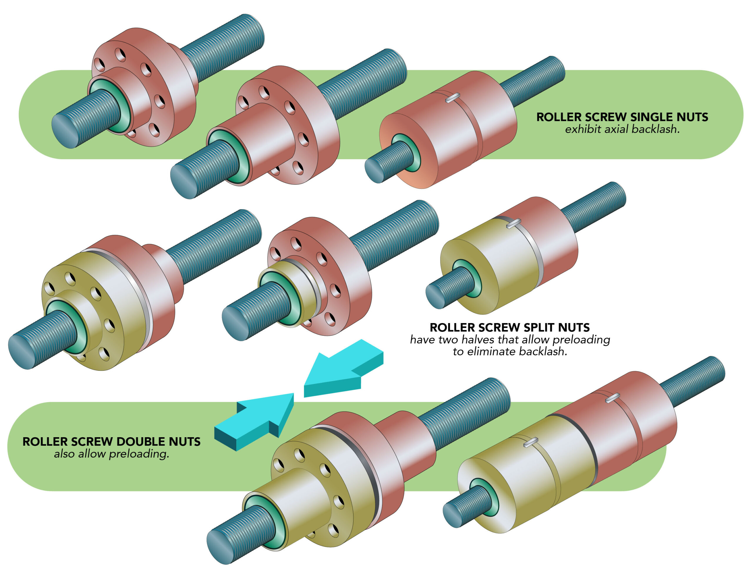

There are three major types of roller screw nuts:
Single, split, and double.
Single nuts are the most common configuration and consist of one solid piece. Split nut arrangements are often used for reduced load capacities. A Custom Steel Cutting service assists by providing two halves of a transversely cut single nut. Double nuts consist of two single nuts pressed together.
Examples of cylindrical and flanged single, split, and double nut configurations
Shown here are examples of cylindrical and flanged single, split, and double nut configurations.
To select the right nut type, design engineers must understand two concepts: backlash and preloading.
Backlash is the amount of axial movement between the nut and the screw without any rotation. It’s an inherent property of leadscrew assemblies due to the sliding motion between the screw and nut. For some applications, a certain amount of backlash or play can be tolerated. However, applications such as positioning, dispensing, or assembly often require precision and repeatability that can’t be achieved if backlash is present.
Preloading is a way to remove backlash and increase the nut’s rigidity. That’s primarily beneficial, but there are a couple drawbacks to preventing backlash. First, backlash compensation typically increases the nut diameter, length, or both. Second, to eliminate or reduce backlash, the clearance between the screw and nut must be eliminated or reduced. When clearance is removed, sliding friction between the components increases, causing higher heat generation, decreased efficiency, and shorter life. Nonetheless, anti-backlash features are often preferred, especially for applications that require precision, repeatability, and rigidity.

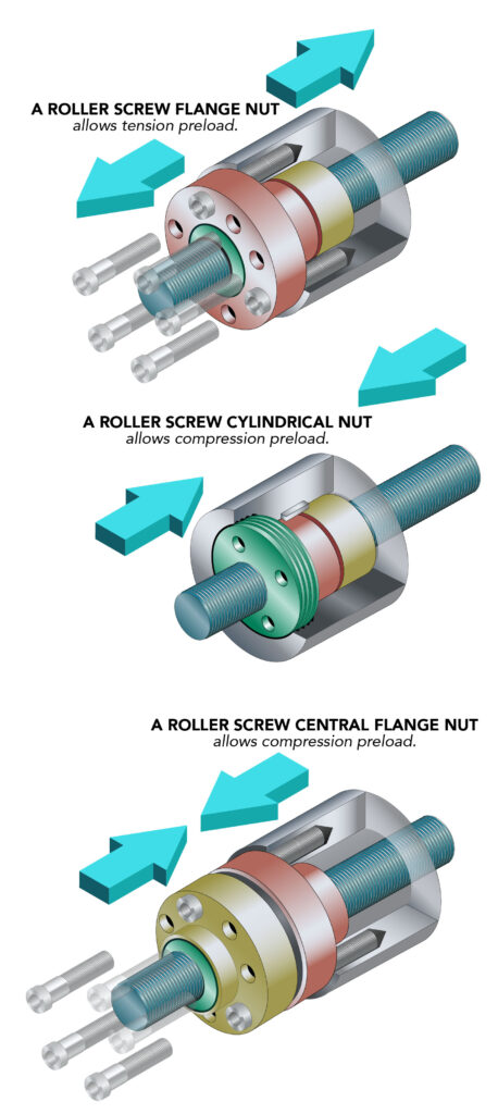

Single nuts have low to no backlash and yield a long service life expectancy. Split nuts are preloaded to eliminate backlash, usually by clamping the two halves in a housing and mounting a spacer ring between them. Split nuts with a flange at one end have a spacer ring designed to hold the halves apart, and a parallel key aligns the halves. Double nuts are preloaded like split nuts. Cylindrical and central-flange nuts are usually preloaded in compression, whereas side-flange nuts are preloaded in tension or expansion.
Roller screw nut preloading examples
Nuts with flanges on one side are preloaded in expansion, while central flange and cylindrical nuts are preloaded in compression.
