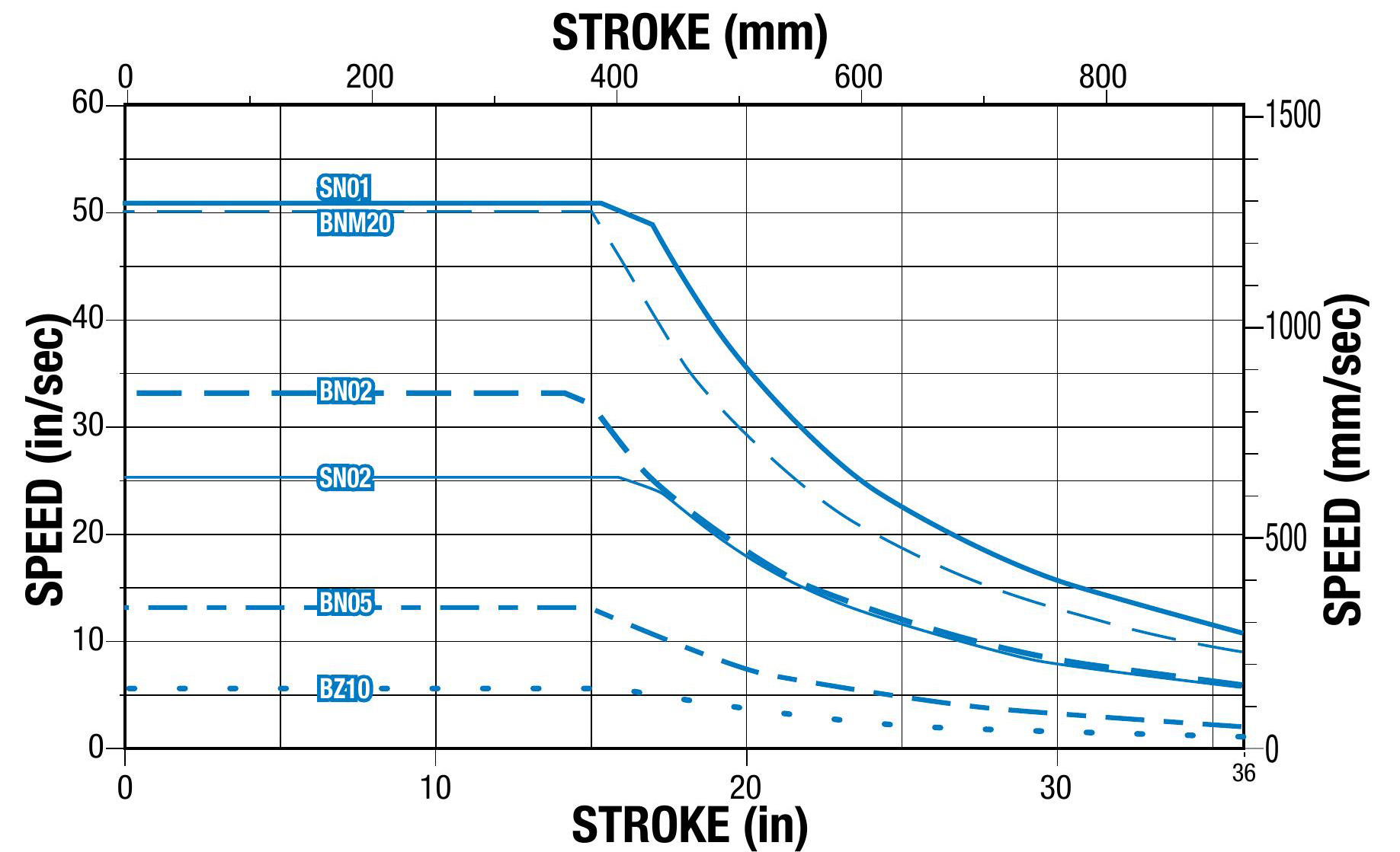

While the required travel is less often a make-or-break criteria, it’s important to double-check that the chosen linear actuator type can meet the specification for stroke length. Ball and lead screws in particular have limited travel ranges. Again, a rule of thumb for screw drives is 3 meters maximum length. Although screws are available in longer lengths, as length increases, maximum speed decreases, due to the critical speed of the screw.
linear actuator
For actuators with ball screw drives, maximum (critical) speed falls sharply beyond a certain stroke length.
Image credit: Tolomatic, Inc.
